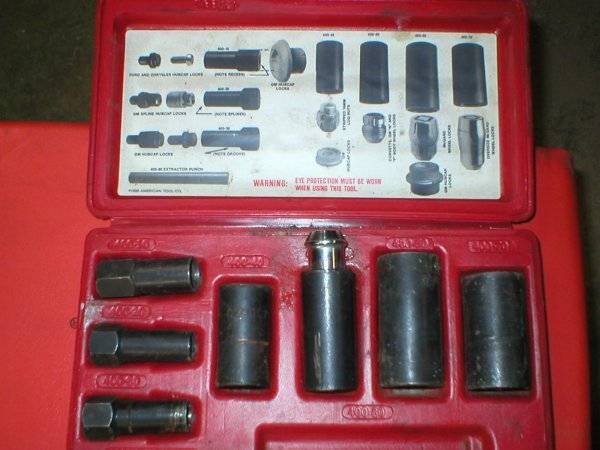

Any tire dealer will be able to remove them for you, they will have a special set of sockets to do so, you can also find a deep socket that just barely fits on the locking nut, tap in on with a hammer and use a ratchet to remove the lock.
The mirror switch is still available from Ford for around $33
Goodyear and Firestone dealers often have a special tool to remove them , just restating what LSC SS has just said............
I saw a similar kit, but more tools, and my local LM dealer a few weeks ago......
I bought that kit back in the early 90's when I was working at a shop full time, I'm sure the kits have gotten more advanced lately !!
