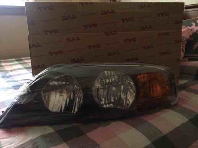

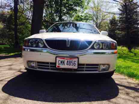

Instead of renewing I just replaced headlights with a TYC set. Really great fit and makes the car look 100% better

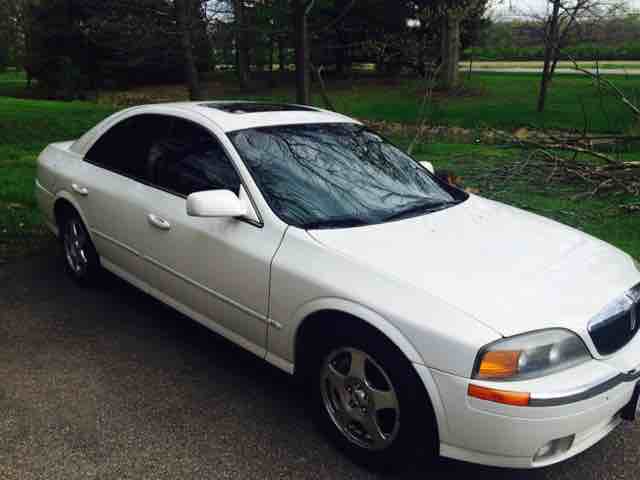

Went really dark with 5% tint all around and 50% on the windshield.

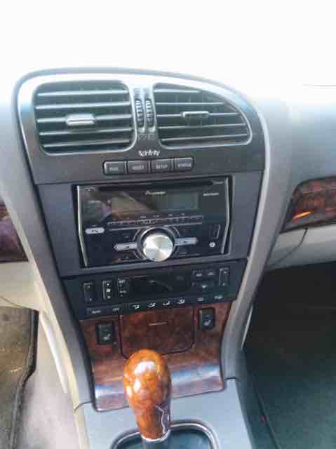

Double din Pioneer with Infinity Speakers.

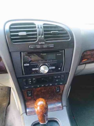

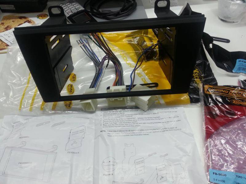

I'm going to have to get a different faceplate kit because the gap between climate control and radio is unbearable.
Hi!

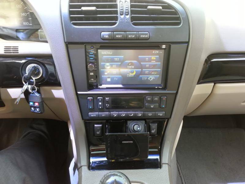

It happened to me too.
Just add a spacer.
You can adjust the climate control position, it has 2 screws , 1 per side.
The climate control has 2 tip , some times you have to cut them.
This is how mine looks.
best regards!
--If you use the factory amplifier don't forget to adapt the remote signal adding a resistor of 1Kohm

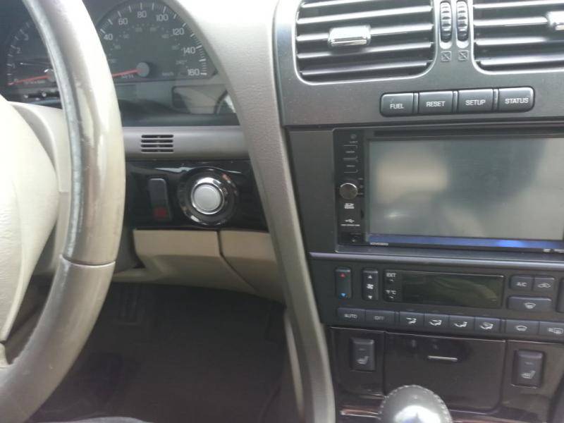

Nice. Yours fits a lot better than mine. I also wired in a resister that drops the factory amp turn on down to 5 volts. I also snipped the climate control tabs down a bit. Mine had 3. And it also had 2 screws on each side instead of 1

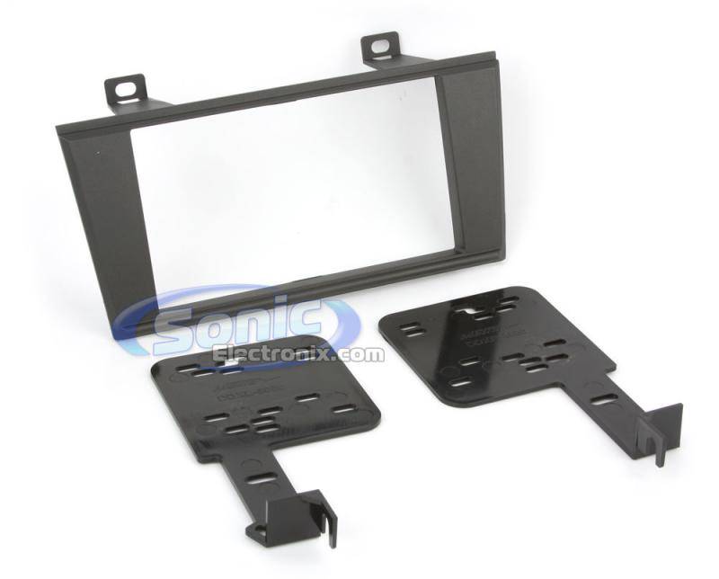

That looks really good G-RELL. The one I used works but the fit is horrible. Nothing lined up with the factory metal brackets. I can't remember the brand name off the top of my head, American something. It was from Crutchfield
Thanks joegr! I've been doing some research. Is this one you've used before?
Yes, except I used the Metra 95-5000S, which is silver to match the gen II. The fit was perfect.
Yes, the pastic bracket does not line up.

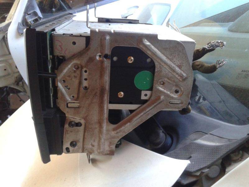

I had to drill the metal brackets.
This does not line up. I own this.
radio's Metal brackets
I could not get this one.
Bleah, don't like that Pioneer the way it's mounted. I think I'd try mounting it so it sticks out a bit further, and use the bezel that comes with the Pioneer. The way it's mounted right now it looks like the hole is square but the radio is hexagonal, leaving ever increasing gaps from the center to the corners on the sides. The Pioneer bezel mounted against the mounting bracket might solve that issue. The picture of the Pioneer on the box, using the bezel, looks a lot better the way it lines up the sides. G-Rell's stereo, while not the sort of thing I would want for myself, looks a lot better on the install and looks like it should have been there.
Personally I like the older single DIN stereos over giant distracting screens in the center of the dash. I consider my stereo to be there to listen to, not to look at. Plus, car thieves look at single DIN stereos as not worth the trouble these days and won't break into mine to take one.
Finally, while I've not used one on my LS I've also used Metra adapters in the past. They've always done an excellent job of designing their adapters to fit the car they are going in and make the stereo look nice.
I got s good deal on the Pioneer and have always had good quality and dependability with them. I'm not keen on the looks nor am I on spending a ton on features I'll never use. To each his own I guess
