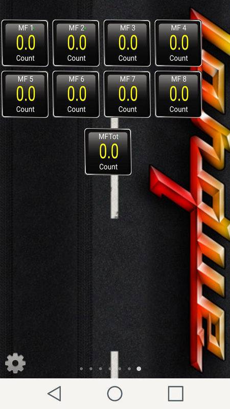

Twice since owning my 97 I have had rough idle and tip in when warmed up, but nothing when cold. I had hoped to be able to use the Torque app and my Bluetooth OBD-II adapter to get misfire counts for each cylinder, but it never has worked for my Mark VIII (I think I got it to work with my 2000 Grand Marquis). I had to wait for it to fail so bad that it set the CEL, and usually didn't do that with one marginal COP but with 2. I just keep a few (down to 4) COP/Boots from the junk yard in the car to swap them out as I can get them to fail.
I had hoped this would show counts, I do need to try it with one of the bad COPs in place, or leave one unplugged to see if it really is zero, but I think there are always misfires, just takes a certain number to trigger the CEL or blinking CEL.

I've never been able to get the reading off the cops using torque either.
