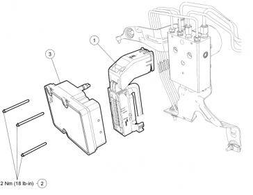

This should help.
Anti-Lock Brake System (ABS) Module
Item Part Number Description
1 — Anti-lock brake system (ABS) module electrical connector
2 2M101 ABS module bolts (3 required)
3 2C219 ABS module
Removal and Installation
Position the battery junction box (BJB) aside.
Release the clips.
Position the BJB aside.
Disconnect the ABS electrical connector.
Remove the 3 ABS module screws and the ABS module.
To install, tighten to 2 Nm (18 lb-in).
NOTE: Use the diagnostic tool to configure the ABS module.

This should help.
3 2C219 ABS module
Release the clips.
