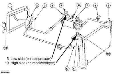

Please help does anyone have any idea where the low side line location for ac charge is ?????
If you turn the wheels to the left, there is a small cover in the driver side wheel well above the A-arm. I think two screws hold it in remove it and it is on the back side of that.
Well i just glanced after dinner and didnt see anything that would resemble that are we sure ?/
The low side port, which you hookup to in order to charge the system is located on the compressor. The compressor is along the accessory drive belt path on the low, left side of the car. Remove the tire and inner fender skirt. Look to the left of the suspension towards the front. You may need to loosen the underbody plastic gaurds to expose the compressor. Then look on top of it for the manifold and low port side. I believe its # 7 here:
That has to be the stupidest location for a low side fitting I have ever seen. I could get by without a high side fitting if I had to, but never a low side. Some engineer ought to be taken out to the wood shed for that design.
