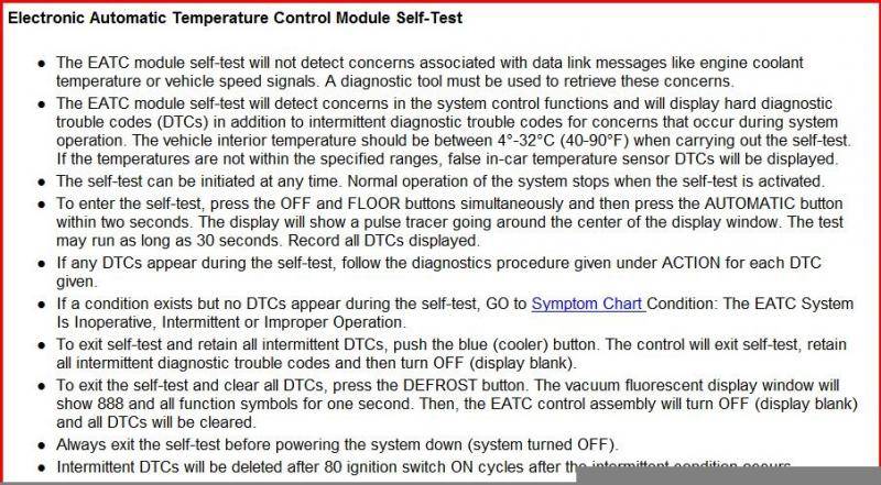

A couple of observations...
The electronic function of the system works - it automatically select either heat or cool, as needed, and changes the blower speed, depending on what the thermostat is set to relative to the interior temperature of the car.
The AC compressor is working and there is a very noticeable difference in the temperature between the hot and cold lines when it is running (DEF mode or when it is turned on, depending the temperature selected on the controls).
Any suggestions?
