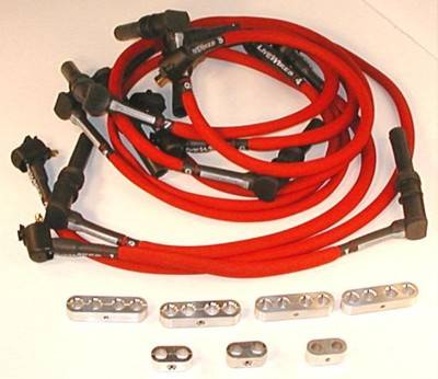

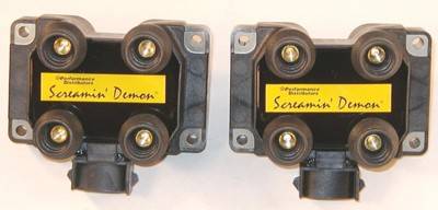

i am going to be replacing my coil packs and wires with screamin demon coil packs and replacing the wires with live wires,and billet looms,from supercoupe performance they are 315 for whole kit, pretty good i think, ,one question....i am running autolite copper plugs now, what would you suggest i change to? i can open the gaps to a .065 with this kit.....stay with copper ?

Copper. 0.048" gap. File back the ground electrode to 1/2 way over the center electrode and round off the end. Debur and recheck gap.
PLEASE dont waste your hard earned money on that crap!!!!!!!!!!!!!
Theres is absolutely nothing wrong with the stock coil packs and Ford Motorsport wires.The stock coils had plenty of juice to fire my plugs under 25 plus LBs of boost they will be just fine in your application, no matter what it is.
Find something else worth while to spend your money on.
TRUST ME ON THIS ONE.

True for the most part, BUT if you need to replace faulty wires or coils, I see no problem 'upgrading' as well. You would actually need a scope to check the coils.
Looks like $315 of bling bling ... that's it.
Take it back if you can, and spend the money elsewhere.

I've been getting the scoop on those coil packs. The factory ones work just fine according to Higgins Ford Performance, Mustang Motorsport, Modular Powerhouse, and Mustang Services...catch my drift? Nothing wrong with a nice set of wires though. And copper plugs save a little cash!
thanks guys, i havent bought em yet i was thinking of it, i have motorcraft 8mm plug wires now, so what is the part # for the others or the cobra ones, how bout MSD wires, i want to replace my coil packs cause they got 160k on em just want to freshen up, do you reccomend i use motorcraft or ford racing, are the cobra coil packs the same? give me info...thanks
Your wires are fine, dont touch them.
Just use factory Ford coil packs and some AWSF-22C plugs
