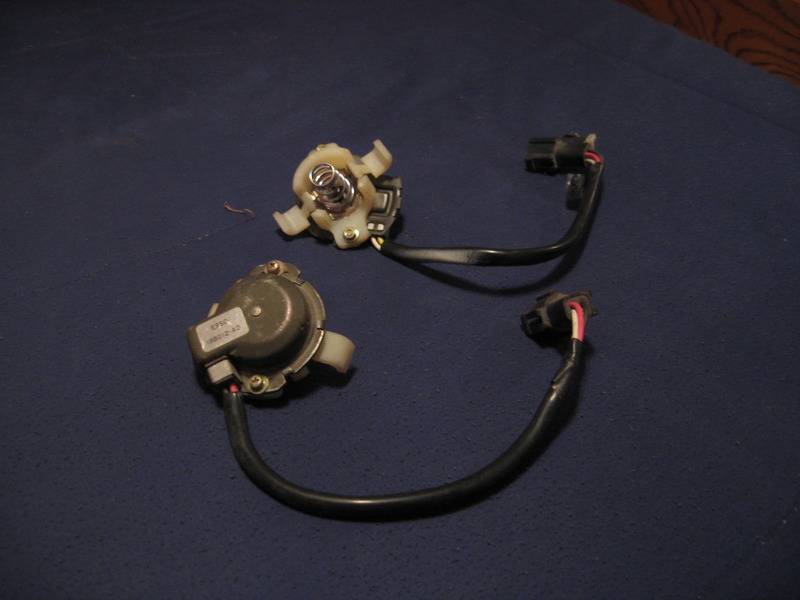

From what I understand, some early GEN1's had automatic adjustable rear shocks and some didn't. If you don't have the solenoids in your trunk, then either your car didn't have them or they have been removed by a previous owner.
The whole purpose of the adjustable shocks in the Mark VIII was to reduce dive on braking and squat on acceleration. The shocks would automatically switch to a "firm" setting upon hard braking or hard acceleration to reduce dive and/or squat. Under normal driving conditions the shocks would remain in the "normal" setting. This was only on the rear shocks. Mark VIII's never got the electronically adjusting front shocks like T-Bird Super Coupes or Cougar XR-7's, unfortunately.

Just leave the shock in there if its good. Solenoids can be removed since they don't really do anything

I think he said that he bought new OEM adjustable shocks and that his car didn't have the solenoids. That's why he'd have to manually adjust the shocks to soft or firm. The solenoids are there to adjust the valving of the shocks. However, if the OEM shocks have been replaced with non-adjustable aftermarket versions, the solenoids are useless. But since his car didn't have the solenoids, he can still use the OEM adjustable shocks. They just won't adjust automatically.
If he could find a set of the solenoids it would be possible to wire them into a rocker or toggle switch on the dash or console to manually switch them from soft to firm at will:) That's what I did with my '87 Mustang when I put the '88 T-Bird TC ARC shocks/struts in it.

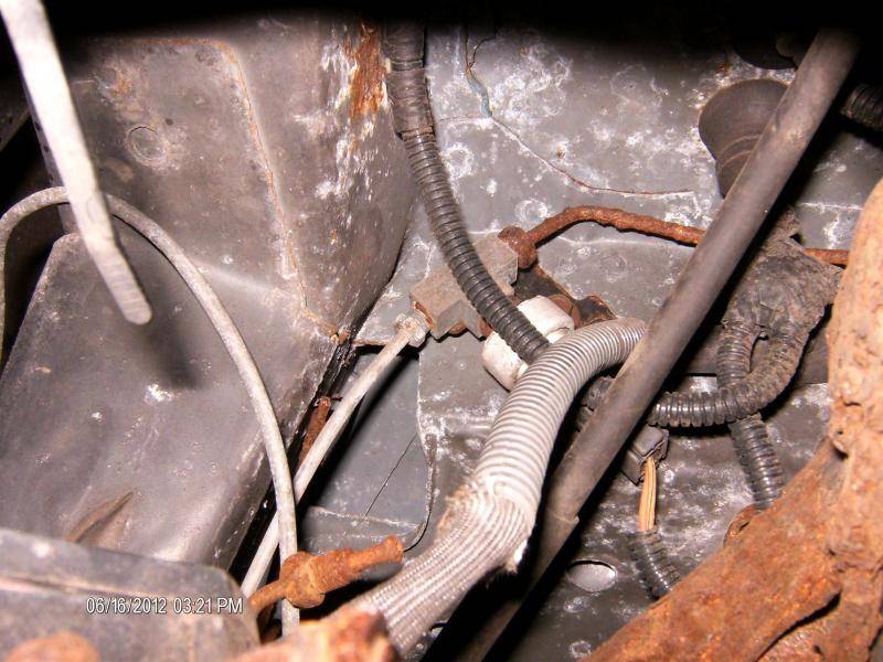

If you have this junction block in the rear brake line, along with the attached pressure sensor and wiring in your car, then it was originally equipped with the adjustable shocks.

Also, if the solenoids are there, which they should be unless someone before you removed them, when you turn the key on, you will hear 2 clicking sounds from the rear. It sounds like something is engaging in the rear brakes or something. Do you remember this sound I describe? The 93 and 94 I had both done it and had those shocks. The current 95 does not and I see no difference in the two and I'm glad I don't have to hear that sound every time I start the cars. Someone was always asking what the sound was and I had to say "it's the shocks":rolleyes:

Thanks for posting that pic Chris. My 94 and the 93 both had those shocks in them when I got them. Always wondered exactly what that part looked like out in the open. I saved it for future reference. Seems this question comes up every so often.
