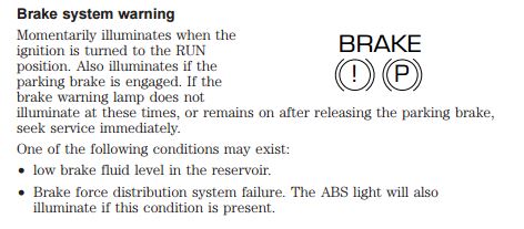

The ABS light is not on. I checked that a couple of times last night after searching the forum. Only the two small red lights. One of the red lights is for the parking brake, the other one according to the manual is called the 'brake warning light'. And the Advancetrac light.
Hope that pic attachment worked ...

That's just one light (there's only one bulb behind all of that), and it's the brake system warning light. Does the ABS light prove out (come on briefly when you start the car)? I am going to guess that it doesn't.

After posting I thought the same thing about the brake warning light. Never paid attention over the past 15yrs if one or both of those red icons came on when the parking brake was engaged :)
I don't know on the ABS light. I know it's not on when the car is running. Will have to check the other scenario.
