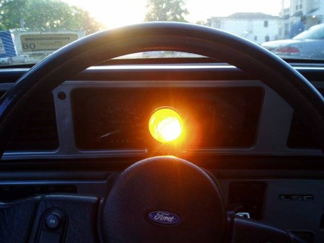

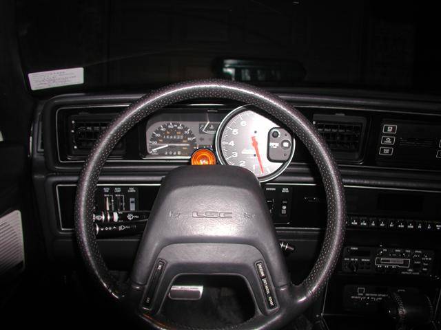

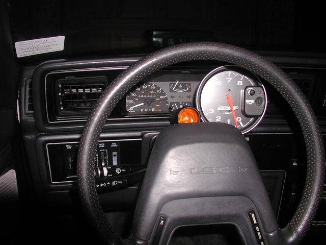

well, it was very easy and turned out great ... I love these old 5.0 engines - so easy to deal with ... :L

I notice you've sitll got the 85 MPH speedo, just like me (an '89 LSC). Know of any source for a 120 MPH or 140 MPH speedo? Or a set of gauges that are white faced? The dash lighting on mine is positively dismal. The interior lights are pretty dim too. One time, for about a week, I had one rear "C" pillar light that was bright enough to be acceptable, but as unexplanably as it brightened, it dimmed back to original. I wonder if there's a "secret" to be learned here.
