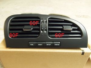

I found that when running my AC, there is always a little bit of heat passing through. I even took a therm probe (Turkey thermometer) and measured different temps in various locations on the air vent.

I've just discovered something today though. When I change my air mix to dash/floor vents, I get cool air (55F) in all the dash vents and hot air on the floor (100F) but only the driver floor vents. The passenger floor vents are still cool around 65F, but not quite what it should be. I've resorted to just taping over the driver floor vents to shut them, but I'd like to get to the bottom of this.
