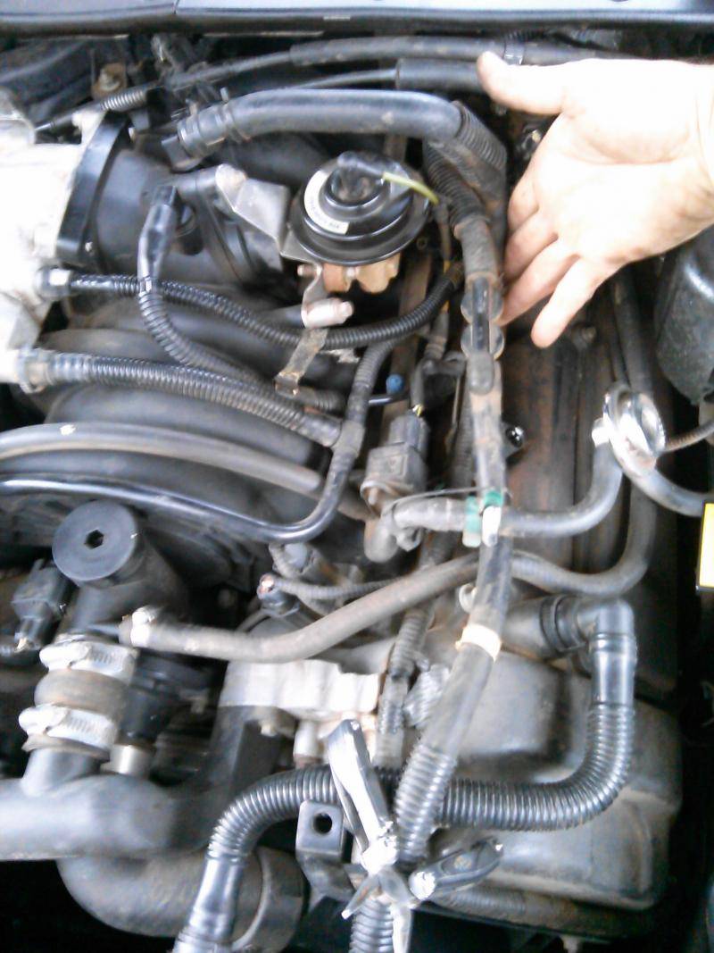

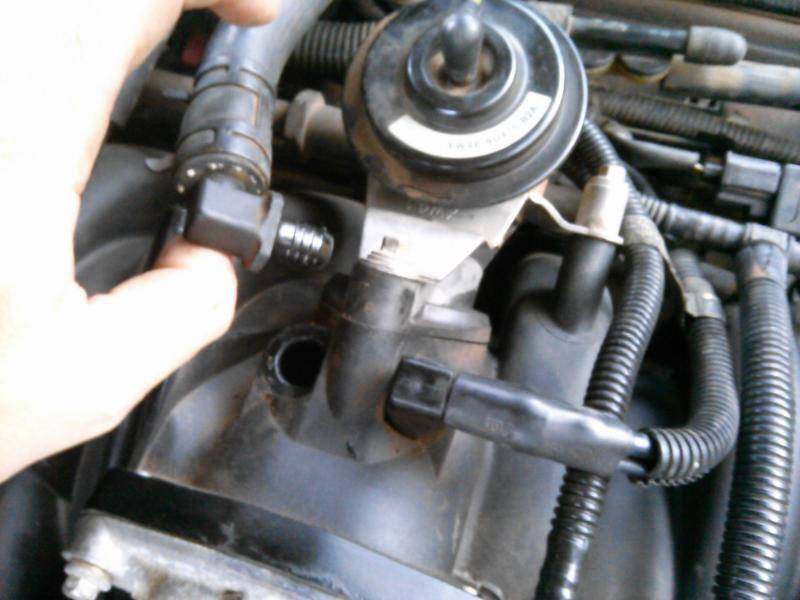

Can someone please help me identify what part is in the attachment. Over last few months LS has been idling irregular when you first start it up. The other day it got worse. When I crank it, it idles up and down and acts like its choking to deathl. I think I have identified where my problem starts. I just don't what these 2 parts are called. I have a mechanic friend who I live a long way from so I sent him pics of it and he said it was the PCV valve. I think he maybe incorrect since looking on web Ive found that PCV doesn't quite look like what Im dealing with. Any help would be greatly appreciated. Im thinking that if I replace these 2 little elbow things and the grommets my problem may go away, not sure just trying to see if this is gonna do it or if my problem is a little more serious. I just need help finding out exactly what this is. I thought maybe a vacuum hose but I have no clue. Thanks IMG_1415827937842.jpgIMG_1415828098223.jpg

I tried that and at one time it would cut it off when you reconnect the MAF sensor but now it doesn't do anything when u disconnect or reconnect. If I unplug both hoses in the pic and plug up the holes with my fingers it tries to run right for a 15 to 20 seconds then starts choking again. I thought maybe that the computer could be over compensating for some reason since this was an issue that has gradually gotten worse. Also in the first pic, the hole that doesn't have a grommet in it, the grommet was completely worn out and didn't have a good seal so I figured that was a good place to start. I just don't know the part names for a lot of this stuff. I don't want to ask for the wrong thing at autoparts store

It still runs now and there's no change whatsoever with MAF unplugged or plugged in. I'm thinking I'm dealing with a vacuum leak. I found 2 different plastic vacuum hoses that were dry rotted and my initial instincts were also correct about the PCV valve. The hose on top of pcv fell apart in my hand when trying to remove it. I hope this solves it.

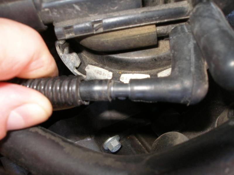

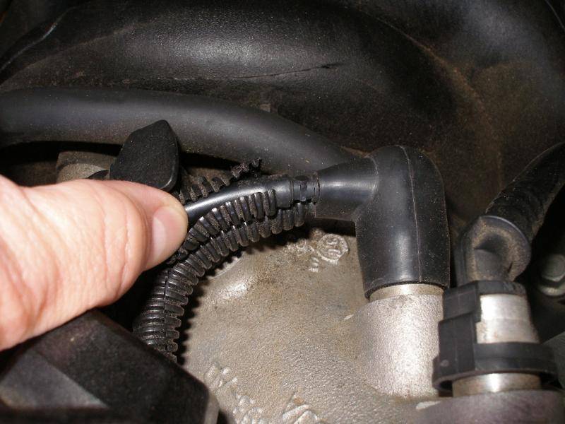

That sounds like a vacuum leak to me; been there done that many moons ago on a previous car. I got a code on my '06 (I know your 1st gen is a bit different but the principle is the same) for what was turned out to be a vacuum leak. Apparently when I cleaned my throttle body I cracked a couple of lines to/from the EGR valve. Somewhere around $10 later in vacuum hose and fittings later problem solved. There's a thread here somewhere, but here is a pic of my patch fob. I did use the factory connections at the fittings....

Funny, that surely looks like a gen I 3.9 V8. However, the 3.9s (gen I and gen II) do not have PCV valves. (There is a PCV system, but there is no PCV valve.) How about a picture of the thing that you think is a PCV valve?
(The round thing in your first picture is the EGR valve.)
