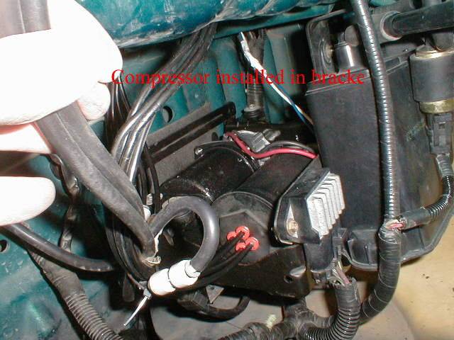

There is no such thing as a load leveling relay on the suspension. The only relay is the compressor relay. It is located on the outside of the bracket for the compressor inside the passenger inner fender. The pic I have attached has the relay mounted to the bracket for the compressor....it is the finned silver/aluminum part just in front of the compressors dryer.
How the system works, is when you add weight to the trunk, or the interior, the height sensors notice a difference in the resistance and then controls the compressor, and appropriate solenoids to add air to the appropriate air bags to inflate them....or deflate them depending on the direction of the resistance. Hope this helps Dale.
