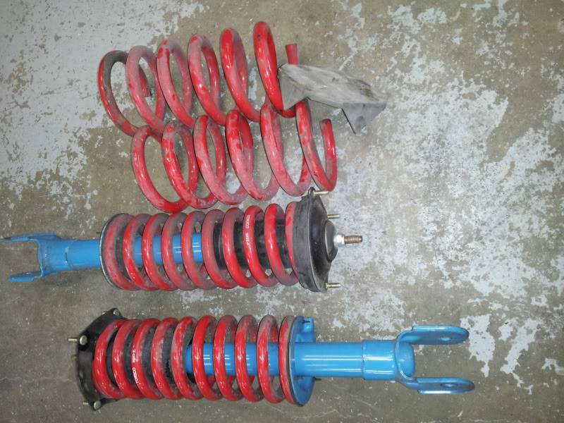

Yep, I had a whole reservoir system with larger solenoids and a drier ready to go in my car... Front bags started to leak and I said screw it. Got the coil spring setup from a SuperCoupe in the junk yard, couldn't be happier.
