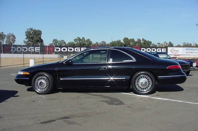

Just picked up my car, less air suspension, I love the look, lowered approx 1.5" with the new shocks in the rear I now have a much better ride!!! My g/f even noticed that the car was lower ( and thats saying something ) lol. Next month sway bars front & rear. :L much better now !!!!

are your cars 1 1/2 inches lower than the inflated airbag height or deflated airbag height?
it would have to be 1-1/2" lower than stock or inflated bags because if you car has deflated bags you are basically riding around on the frame
I think he meant "vented" bags...aka freeway/parked height.
My car sits at about the same height as a mark VIII would that has been sensor lowered. But not sensor lowered to the hilt by relocating the sensor mounts... just if you slid the front sensors up to the max position in the slot, and the rear to the top position(compress front sensor, extend rear).
I have about 1-1/2" between the fender lip and the top of the front tire, and the rear fender lip is about 3/4" from the top of the tires( the two wheel arch's havea different arc percentage)
I am very happy with my ride height...the black 94 has the coils... the red 97 LSC has air(engine is running in the red car, so bags are at "cruise" height...when off, it drops to about even with the black 94)

I bought the conversion from Tim @ Struts-r-us, I used Monroe Stratatrac in the rear, something else I noticed this morning the car is more level, weird.. Prior to this conversion the car looked a little lower in the front ( check yours out I'll bet it does to ) since the conversion the car looks absolutely level, I think it gives it a whole different look. Total cost was $ 753.00 & thats including a 4 wheel alignment !!!

That does look good.....I just like the adjustability....for now, maybe IF I get anudder one I may go wif the coils.....I have to ride in one first though. :Beer
