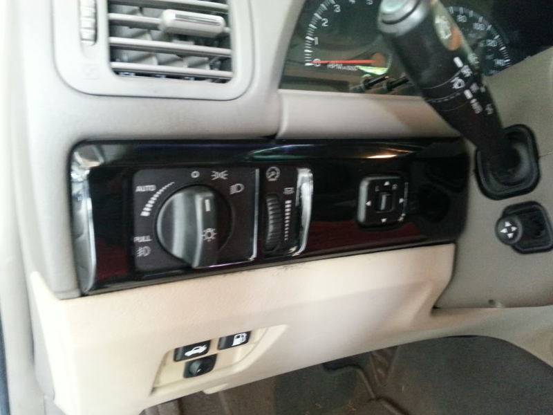

Figure I ask here, after doing some searching I see it has been covered in the Mark threads, but I can't find any on the LS. I got in the car on Sunday and all I could see was a spring sticking out where the fuel door button used to be. Apparently it broke off and shot out and I can't even locate the damn button in the car. I checked under the seat, mats, etc. I'm guessing it broke off and must of fallen out when I got out/in the car. Any ideas if this can just be ordered from the dealer and pushed back in? Is it more complex than that?
... Any ideas if this can just be ordered from the dealer and pushed back in? Is it more complex than that?
I think that you replace it with the trunk switch as an assembly. As quick search indicates that the assembly is more expensive than you would expect.

probable want to keep in mind if you get the whole assembly (both buttons), you will probably want to switch out the trunk button you already have as long as its still good so that your key still works...
Thanks guys, I'll check some local junkyards first and if I have to I'll order the part online for $50. Is it just pop off unclip harness, clip in new part, pop in? Typeadeal?
The first gen button assembly looks way diff than the 2nd gen. Not sure if it would work, but I shouldn't have an issue chasing down a gen II assembly. I've seen a few on ebay including the one Joe linked for ~$50.
