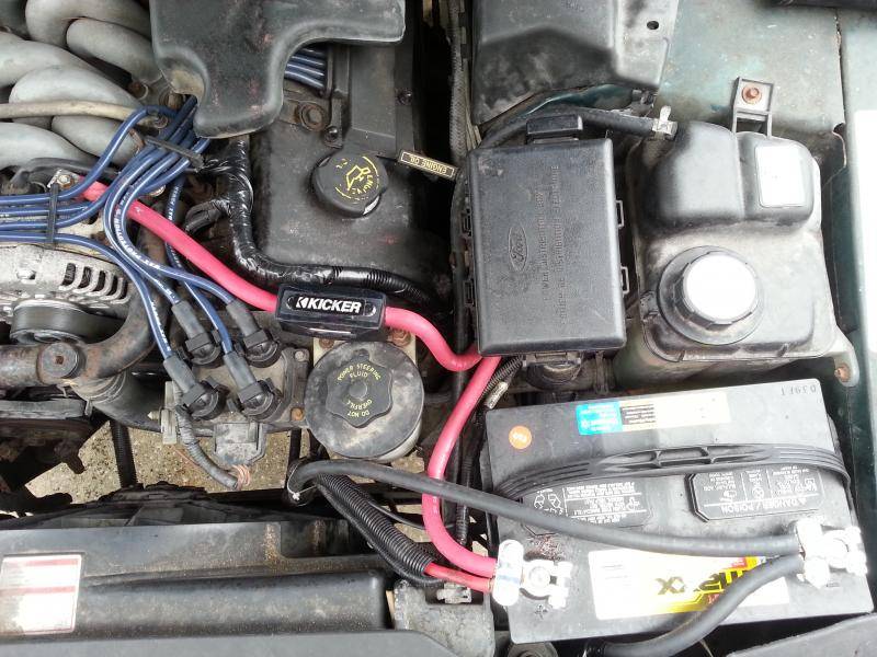

Big 3
After a lot of futzing around, I found if I used 3 swivel extensions and went through the opening where the sway bar was, I was able to get the bolt off. The pain was when the socket came off the nut and I had to realign it again. After so far I had to switch to my ratcheting wrench and finish the job.
Man, look how small that 4ga starter wire looks next to the 2ga power wire- what a pain it is to work with and bend though!

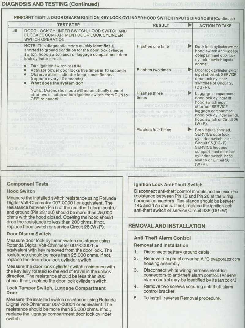

Here's a diagnostic test you can do, this is from the 94 manual, not sure what year your car is.
