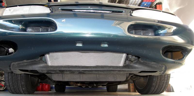

Thunderbird/Cougars & Mark VIII's use the same radiator. A popular swap (which I have done to my Thunderbird) is to put in a 2003 Cobra radiator. It's all aluminum, has no provisions for transmission lines (meaning you HAVE to use an external cooler), and is slightly taller. To mount it in the Thunderbird, you have to flip the top mounts over and swap sides - that's it. All aluminum construction and superior cooling. Here is a pic of the installation in my Thunderbird (sorry for the crappy phone pic):
The '03-04 Cobra radiator is a great choice for these cars.

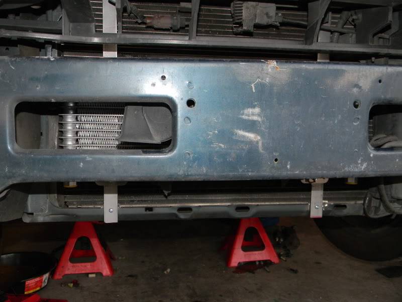

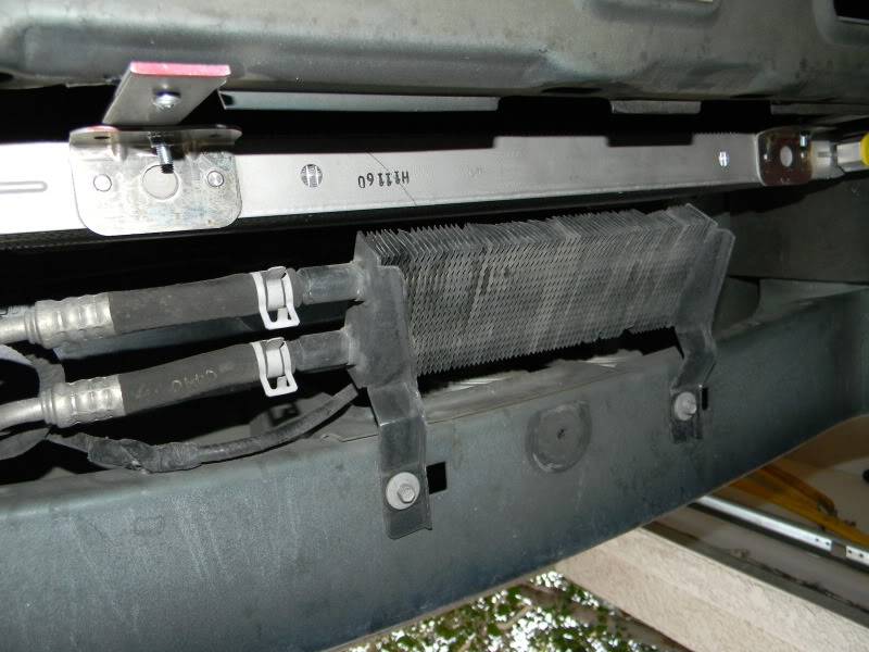

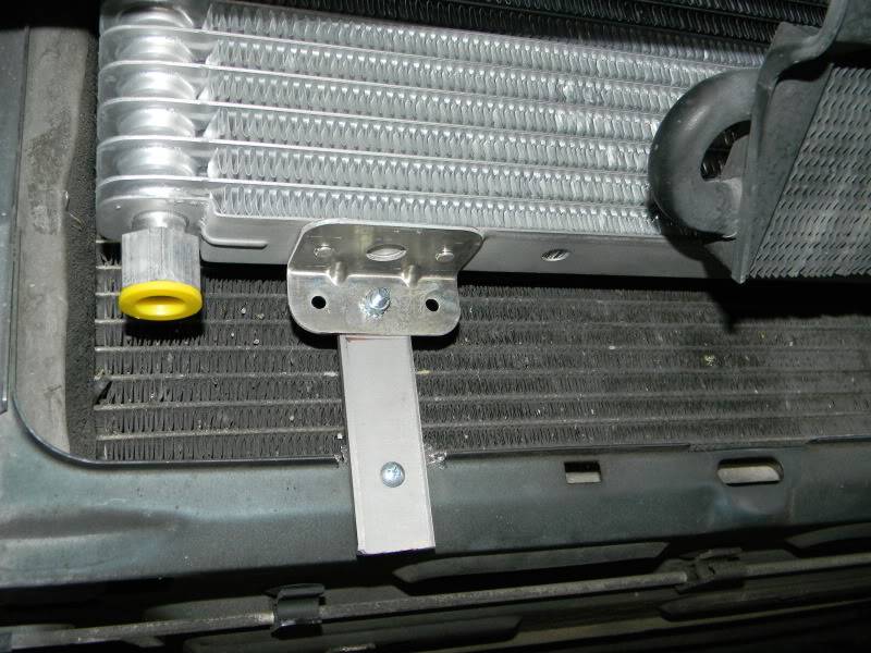

I mounted my tranny cooler directly to the front of the radiator. The a/c condenser is in front of that, so you can't see the tranny cooler even if you wanted to. If I ever had to service it, I simply remove the two bolts holding the mounts on the top of the radiator, lean it back, and voila, there is the cooler.
There is a super large 45,000 btu cooler available that some people like to mount at the bottom facing the ground - that's a cool option too.
