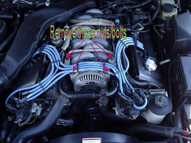

3) Remove the spark plug wires off of the bracket that goes over the alt....you do NOT need to pull the spark plug wires, just pull them off of the bracket and lay them on top of the intake.

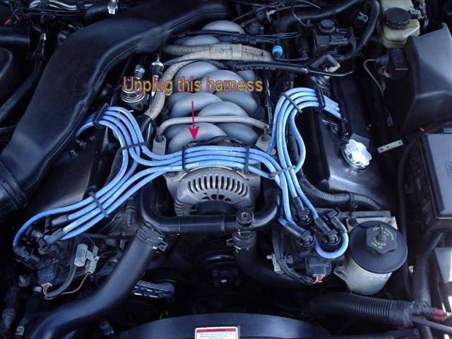

4) Unplug the wiring harness off of the back of the alt. (pic 1)
5) Remove the nut that holds the other wire onto the alternator under the rubber cover. (pic 2)
6) Unbolt the top of the alt by removing the bracket that holds the alt to the engine, and the alt to the bracket.....you do not have to remove the bolts that hold the bracket to the alt until after you have removed the alt. (pic 3)
