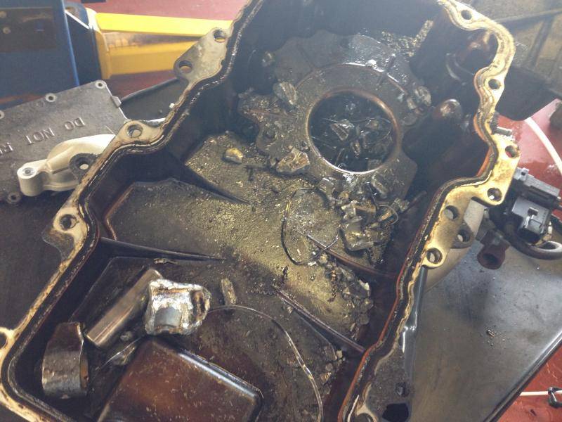

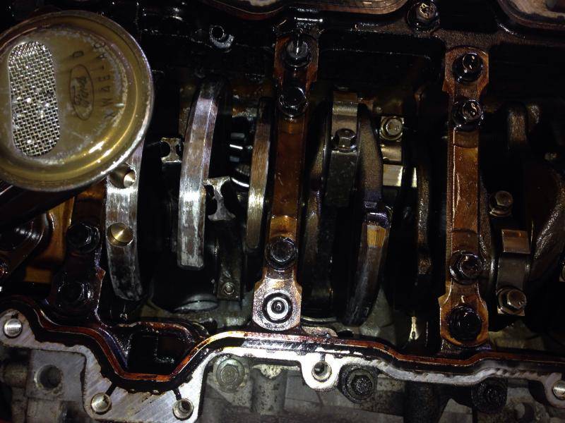

This is my first post here! Been reading for a while though! Anyways I have a very interesting, and strange LS story. The LS I bought, (I'm 17, lucky enough to have help from parents) was 58,xxx miles 2004, Ls V6. We live in SE Michigan but bought it from Bowling Green lincoln in Bowling Green Ohio. The care was absolutely gorgeous, ran great, and we all fell in love. We payed around $8,900 cash, half of which my hard earned savings and the other half my parents. We expected the car to last me trough college and hopefully more. So what we thought, a wise investment. Then the odd horrors begin. First off the dealer never once told us of the 91+ deal which we then read up online about which was no big deal. Then after 5k miles, it was time for an oil change (light never came on though). We go to the Valvoline and there they are shocked at what they saw. On the computer it said the last oil change was at 49,500 miles. We thought the dealer did it (like they should have) and then they pulled out the air filter from not the dealer, but the one that was changed at 49,500. They said that the dealer would have changed the air filter if they changed the oil. Long story short we put full synthetic in and it ran fine (didn't know better of the ride they're supposed to have) At about 60,000 miles the engine starts a bizzare noise. It was knocking, got louder and faster when I accelerated, and just was weird. Wasn't sure what to do. I only could think of use better fuel to clean it out. (Which I now know really doesn't work like that) Filled up with 97 and was good to go. Only the noise came occasionally. Went back to 91 and was fine. A tank or two later, it was back. And louder than ever. So I called my uncle who is a head mechanic at a Mazda dealer (previously ford) and he said he would take care of me! But, he was going in for knee surgery so it would be two weeks before we could go. He said take it easy on the car, try not to go past 2500rpms and only drive when absolutely necessary. Two days later on a Monday I was driving to school. As soon as I pulled out of my sub, and got up to 40, I heard a screech, as if a squeegee was rubbing on wet glass. I immediately backed of the gas, and pulled to the center lane. Turned it off, and started again. It seemed normal for the next .4 miles. At this point I was twice as cautious. As I was taking a left turn, the car started shaking and I heard the same noise, this time louder, and really repetitive so I put the car in neutral and coasted in to a cvs parking lot. We later got it home not exceeding more than 15 mph. A week went by of sitting in my driveway torturing me, and it was time. My dad drove the car on back roads with me in a minivan behind him, not exceeding 25mph. This went okay for a while, but as soon as he accelerated a little bit more to try to turn onto a main road, black smoke out the exhaust, and nothing. Wouldn't turn over, wouldn't budge. We then towed it to my uncle and we awaited the news. The news was, the engine is seized, and won't work. He said he is going to pull it apart and take a closer look. This is what he found.
So on that note he said it would be worth it to order a new engine and install it. He bought one from a 2004 Ls in great shape, and with around 70,xxx miles on it. He then installed the engine, costing us around 2100 which was what I thought an outstanding deal. 1000 for engine and 1100 for labor as it was a good 3-4 days work.
Now, the car runs a ton better from when we first bought it, it's incredible the difference! So smooth! I put in 500 miles with it so far!! And I'm happy as could be! I fell in love with my lincoln and I'm glad to have her back home! But still, there are unanswered questions. I would like any insight you guys have to offer! I want to try to get some closer as to what happened. Please, reply with thoughts, comments, questions, anything!!

First off...... The oil light is for pressure, not change interval. I would get a lawyer and see if you have any recourse. Seems to me the dealer sold a defective product to you, based on the records.
Let this be a lesson, check the fluids before purchase.
All I can say is I recall this story from at least 2 other people who used to be or still are on this forum. One of which I remember was actually an 06 v8. So I don't know the cause. But I remember the loud knocking and then engine seizing part and needing to be replaced. Sucks, but if your 17 and want this car to last they college I would do as much preventative maintenance as you can.

Looking at those pictures, I dont know how that engine lasted you that long. Glad you were able to get it fixed. Hope you enjoy your Lincoln for many years. Welcome to LVC!

Without a good history it's hard to tell what went wrong. Looks like a significant oil supply issue, but hard to tell why or how without being there. That is a whole lot of carnage.

The oil light is a no-oil-pressure light. When it comes on, it is almost always too late. If you don't turn the engine off immediately when the oil light comes on, it will be too late. (If I understand correctly, the oil light never did come on.) The OP should also learn how to use the dipstick to check the engine oil level and condition every so often.
