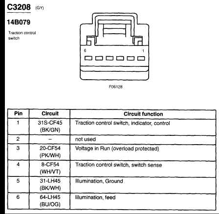

So as i posted earlier about hardwiring your cell phone charger to the car. i found a + and - in the advance trac. since it was right there i decided to tap into that. so i got it there and the charger kept saying unable to charge. so i said forget the advance trac ill just hardwire it to something else. now my advance trac isnt working the fuse is fine, all the wires are fine, what did i do, did u blow the harness, please help with the winter soming im going to ned this to work. thanks in advance
that's strange. what do you mean you wired into the advance track? Are you talking about the button on the console? here's the wiring diagram from an 03 for that harness. there's no +- to wire to!! If you did the signal line you "may" have fried something else.
He probably tied into 5 (-) and 6 (+).

5 and 6 are ILLUMINATION power, only active to light up the button I assume (when lights are on) and probably also run off the rheostat or whatever controls dimming functions. Those wires probably wouldn't work and if they did fry something PROBABLY wouldn't be related to the T/C system directly but who knows in this car:)
I was guessing that he tied into those, since they are the only obvious + and - lines. My supposition was that he might've tied into one of the control circuits, which could have spiked one of the semiconductors related to the AdvanceTrac system.

ok last post for tonight. Pin THREE for positive, and a ground for negative would work great. get a voltmeter and check pin 3 and ground for 12V. If you don't get 12V then you may have blown a fuse somewhere which would explain the button not working.
this switch is fuse 15 in the passenger fuse panel
