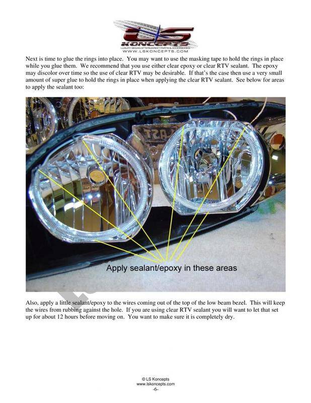

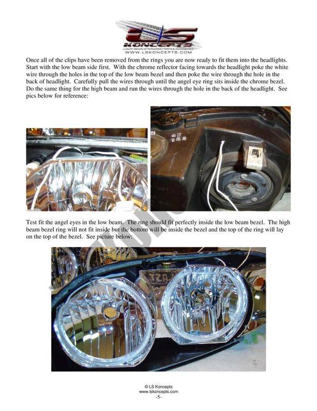

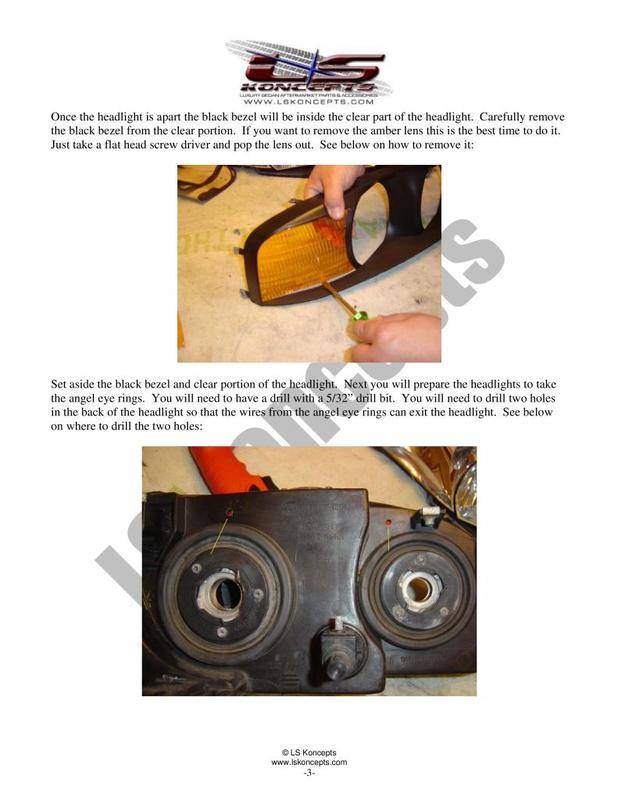

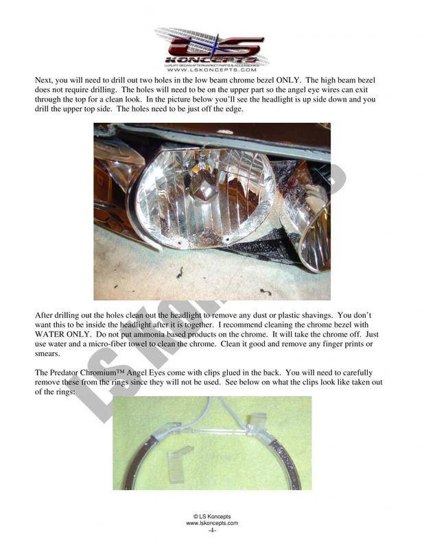

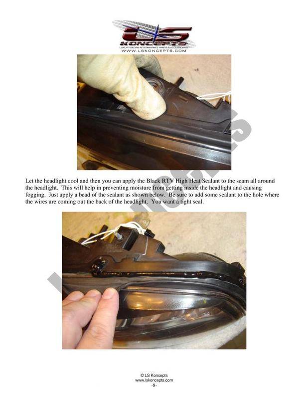

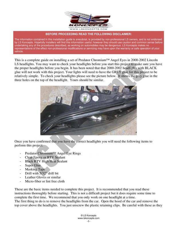

if you do it yourself... If you don't have grey sealant you'll need to cut them open.
(probably follow the 2nd gen instructions to cut)
https://www.youtube.com/watch?v=x_1N1am6tZM
If you DO have grey... then follow these (wiring may be different if you get LED..these are CCFL)
