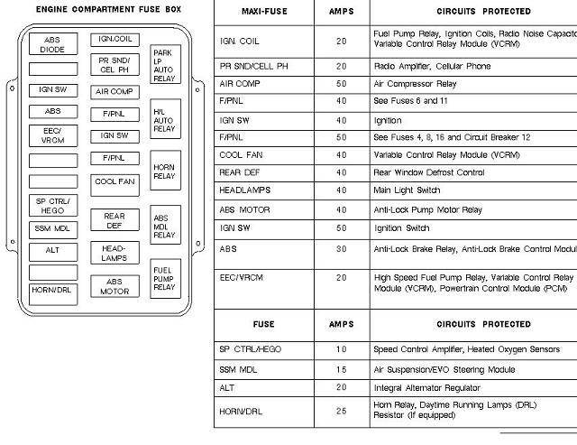

Check fuel pump relay...
Thanks for the help guys. Apparently the Ford code readers' are only useful when the CE (check engine) light is on - in this case there are no indicators - except it won't start! :) I'm in search of the eng fuse box now and will let you know the results.
