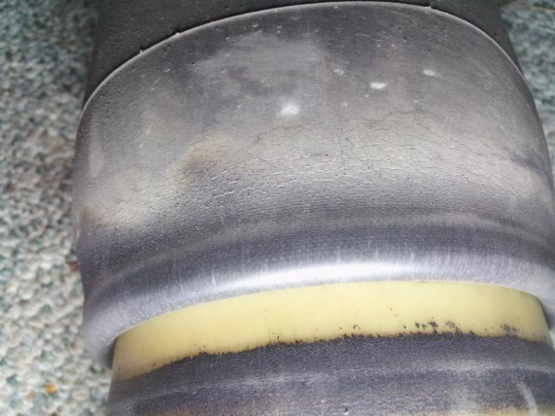

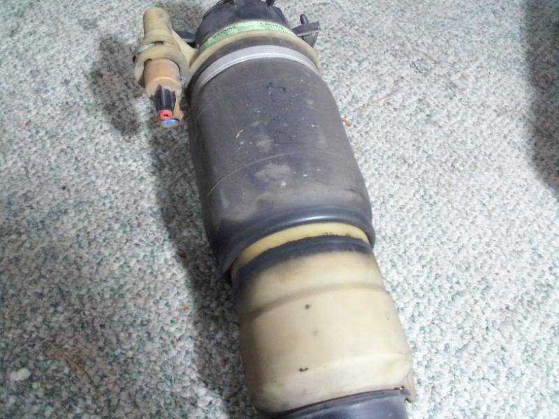

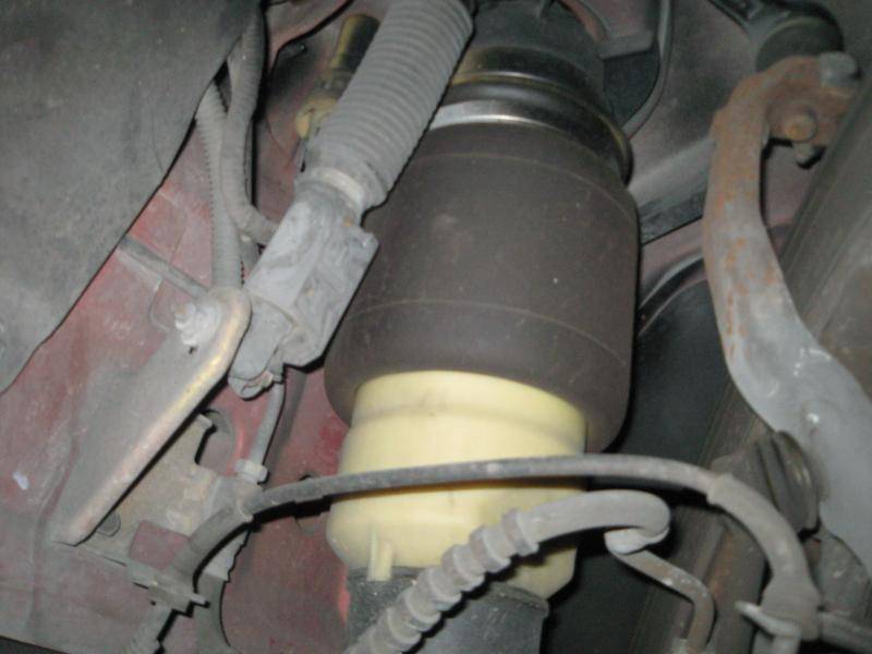

Seeing that your front bags are in the condition they're in and holding air and I mean that as in (they appear to be in very good condition), I would say your compressor just isn't pumping at all and like "American Air" said, if the car is already down and the sensors know it, it's not going to vent because it isn't rising to it's driving height. If you look in the for sale section, you will see a compressor for sale. I think with that, you'd be fixed up. It's still under warranty and was rebuilt by Eddie from American Air, same as mine. Now, to give you an example of what a bad front bag that leaks looks like, see pic below. Note, this bag (air shock) would take two days to leak down an inch.
Turn your air ride switch off and jack the front up and see if your bags look like that when they unfold. If they don't and I don't think they do, I would bet your compressor is shot. Might be running but it's not pumping. After 90 seconds, it times out and shuts off and will give you the "check air ride message"
