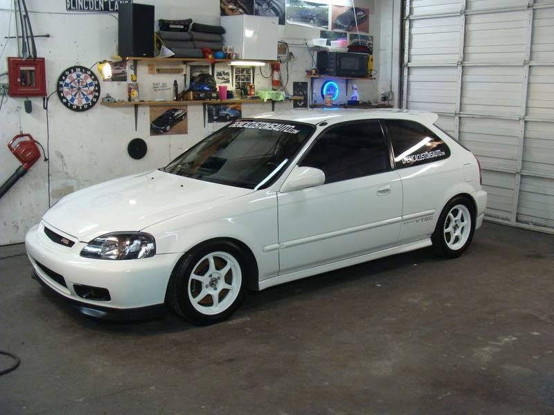

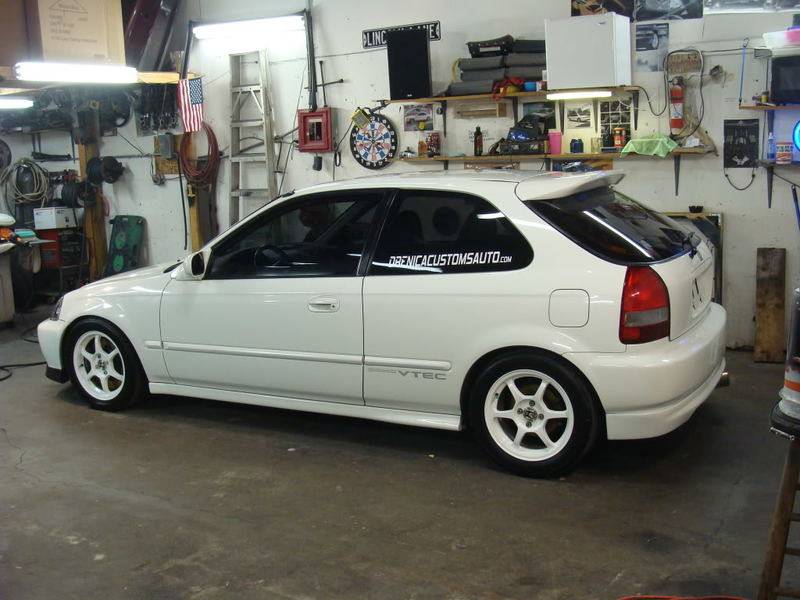

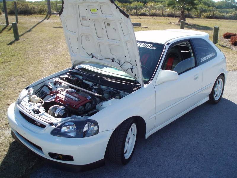

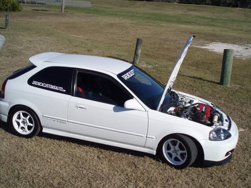

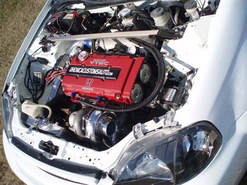

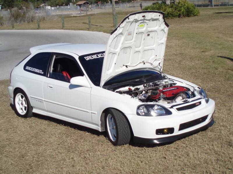

this belongs to my buddy adam, he took these first few pics, but i just wet sanded and buffed the entire car, i had to sand it because the paint had stains and specs of something all over it, it was very dull and poor looking, i didnt think white could really shine to a noticable difference but wow!! this little car is nasty, its a real 2000 civic type R EK over 400 whp with 14 psi of boost. its a very violent car i wont even ride in it but half the reason is because he is an idiot and i'd rather stay alive!! you can see there is alot of $$$$ tied up into this rice cooker.
pics i took in my shop after i finished.
Hey, that's not a bad looking Civic! :)
Looks wise, cars seem to have gotten worse and worse. New Civics are fugly, but I'd rock one of those older shapes any time!
oh yeah i actually really love the look of that car, i'd drive one too, but not with all that crap in it, a stock one like that with some dark tint and nice wheels i'd drive it.

is it me or is there somthing missing from the turbo, on the polished side
You mean the air filter?
Probably a work in progress although i would never run a car without a filter - especially a turbo car - wouldn't want sh!t getting in there, messing up bearings, damaging fan blades and possibly throwing the turbo out of balance and killing it.
I've seen so damn many people running around with open turbos or with just a screen over them.... I would always run a filter.

this car doesnt have clear on it, its a single stage. i also dont wet sand cars like i stated above unless its a very last resort, this one was a last resort but i did the whole car once in one step and started with 2000 grit so i wasnt worried in the least bit. ive been buffing vehicles for quite some time, but recently have been doing alot more. i dont really have any secrets, i just didnt feel like typing, i normally cut a car with clean cut and a wool pad, then i switch pads to a light cut and hit it with swirl and scratch remover, then switch to a polishing foam pad and hit it again with mguires #7 showroom mirror glaze. pretty much it. in my opinion the hardest color to buff is black, and i have done many black cars, and havent left a swirl yet, not many amatures can say that, i see cars on used lots all the time that have been detailed and they look horrible in the sun, swirl city, they look worse than before. i dont really take peoples pointers, i know what works for me, i know how my work turns out, and if i try something that works for someone else, thats when i get problems, i like to stick to my ways!
