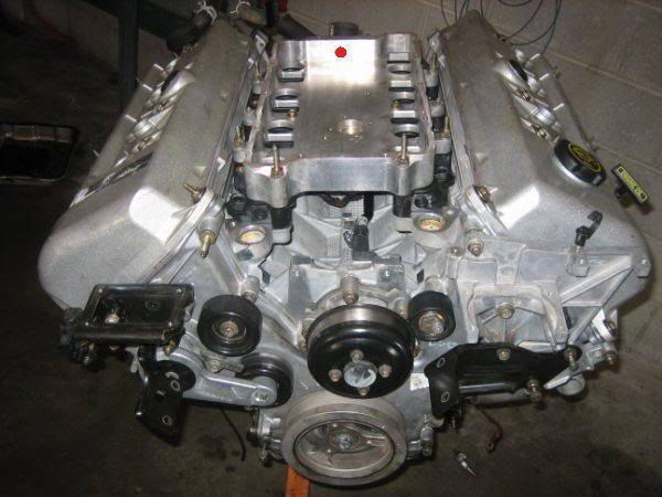

KB not Whip. But I can drill and tap the plenum to put injection nozzels directly below the blowers output.

Yeah I was thinking of putting the nozzel where the red dot is.
