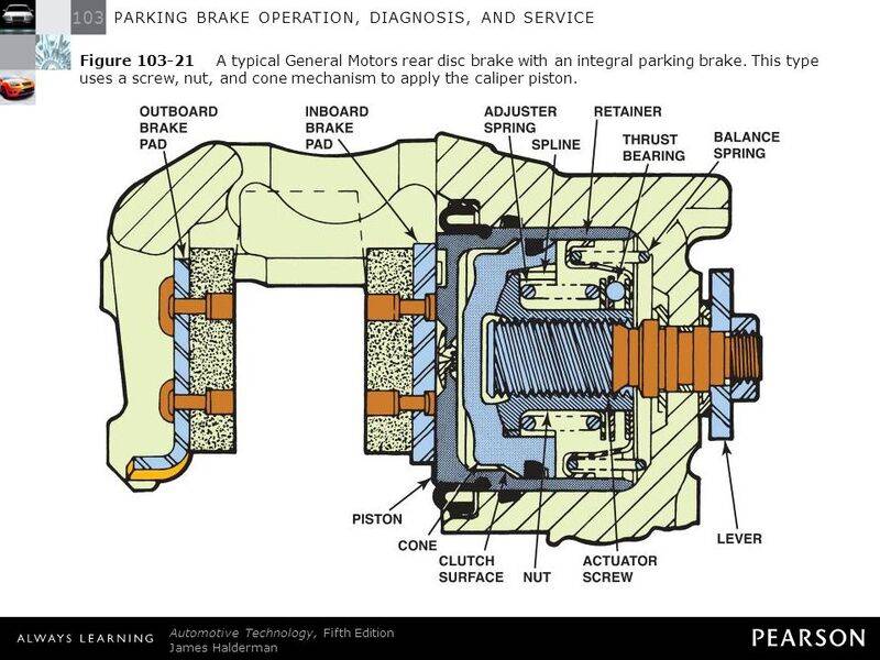

My issue with the parking brake is not electronic if you can imagine that. My 2003 has a fluid leak located at the rotating assembly where the parking brake cable attaches to the driver's side rear caliper. I can't find a drawing that shows that assembly up close and am uncertain exactly how that works or how it can even leak brake fluid. It's not leaking at the brake hose or its gasket. The leak is a very slow constant drip but enough to let me know something's not right. The Lincoln shop manuals don't give an up-close view of it. I put a wrench on what nuts and bolts are there but everything seems tight. I have no other issues with the functionality of the parking brake. Any thoughts on solving this issue? Thanks. Rob
I've never taken one apart. The rebuild kits show a small o-ring like seal that is likely what seals the small shaft from the parting brake lever that goes through to turn the screw in the piston.
I think that you will either have to rebuild your caliper or replace it with a rebuilt one.
This diagram is not for the LS brake, but it should be the same principal.

I'll just purchase a new brake caliper. I thought the parking brake mechanism was a Ford only type of thing. I was wrong. Good news really.
