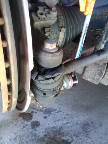

last time i do this, promise. i was changing the rear sway bar links and i noticed this one part was due for changing as well:
Yup, rear toe-links. They are expensive for what they are, like $90 each side shipped from 5starford
They're more functional than they look. They provide the passive 4-wheel steering. There is a collapsible bushing in the conical section.
Would this part be as easy as removing the rear sway bar link? Parts needed?
easy job to replace, no worse than the links. but after all this, dont forget the alignment
oh i know. i'm just glad there wasn't more crap that needing changing as far as suspension goes. i still have to check the fronts well however. thanks for the reply buddy.
