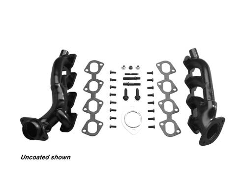

Ford Motorsport lists the uncoated for $350 and the coated for $450. Summit carries them for $284 uncoated but has no price for the coated. I know they won't out perform the Kooks, but less than half the cost and stock exhaust stays. Should get some gains for the $.
Not worth the time and effort in my opinion, gain is around 5-10 HP, with Kooks more like 20-25. I know JC has them and he will tell you the same...
10hp isn't a bad gain for a shorty. I know I read that the logs on the modulars aren't bad from the factory, but I believe most things I've seen were on the 2V. And the install should be alot less involved than the Kooks. Sounds like the $-HP is similar, and if they are a direct fit, I think they may be worth the time. Looks like the crossover tube in front of the motor won't line up, but that can probably be eliminated. What the heck is that thing for anyway, just pollution crap.

I know the Kooks can produce better, but for less than 1/2 the money still a waste of time? Did you get 10HP or hands down no power gain.
I would say 10hp would be a good call, and yes I could tell a difference in sound and power but I also added a custom made X-pipe and dual exhaust so total gain was probably 15-20 hp. also go with the coated one's. not a waste of time IMO.
Thanks. I'm going to find out what the coated ones cost. I'm on stock exhaust but mufflers for now, but X on back is in the near future, may just clip the 3rd cat and swap in a X with the stock LSC pipes for now. I have a connection it will cost me peanuts. I Just have a hard time with the Kooks cost.

I've got Summit getting me a cost on non-COP spark plug covers, spose to call them back tommorrow. They never sold them so it isn't in there system, but the COP ones they have, he threw that price at me for a close quess price, same as Fords price so I expect them to be same as Fords price.
As far as the headers the coated price isn't on the web-site, but I'll ask them when I talk to them and post it, the uncoated seems pretty cheap so hopefully the coated is only 50-75 more.

can prolly make full length, if you have the patience to form the pipes around everything.
is what I'm thinking. Seems that the shorties would provide a much easier way to mount them than 3/4 length Kooks.
