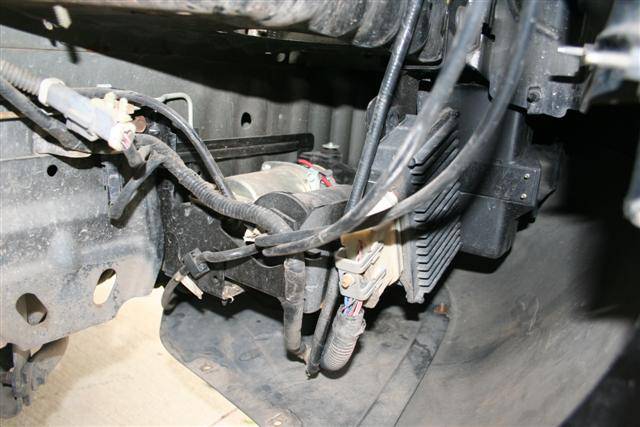

The compressor should be under the Airfilter box, here.
At least that is where it's on my 98.
Thanks buddy!! that was a good shot, enough to take me there!!
now to find the valve!! lol
