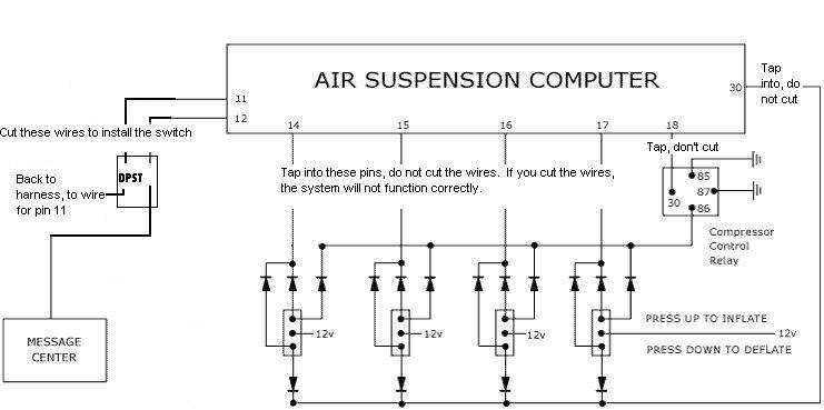

If your into electronics you could use a varaition of this schematic to "tap" into the suspension computer and get air to the front. If this interests you, let me know, and I can provide the directions to get this in temorarily.

Yes, there are a couple of different ways to do what you want.
On my 95, I have the switch setup I posted earlier, and a spare dryer with a tire schrader valve connected to it. if I get in a jam, I can swap the dryer out real quick, hit the switches to open the solenoids, and fill it with air from a shop comressor.
You can't just apply air to them, the solenoid has to be opened to allow the air into the bag. (hence the switches i have installed.) Have you tried getting the compressor to come on? if it's not working this is all pointless untill you do.
