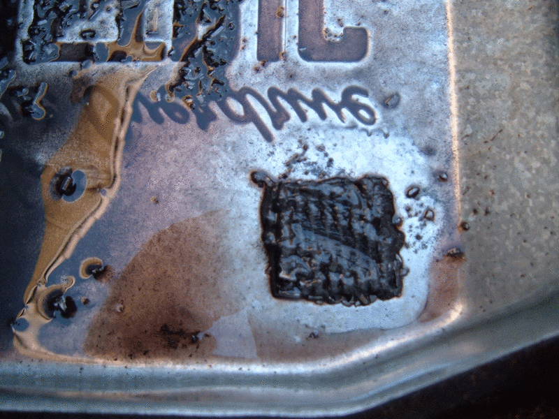

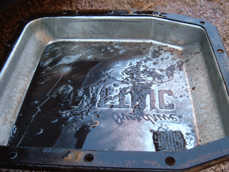

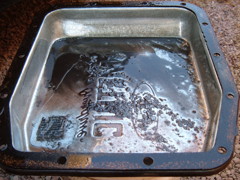

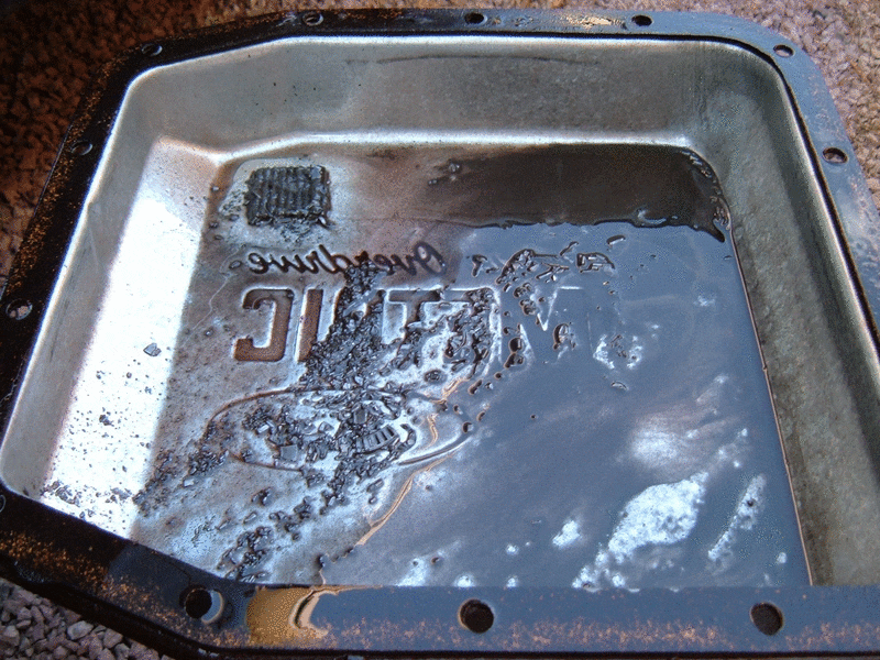

Can anyone guess what failed in the transmission? I saw needle bearings and what looks like part of a bearing housing? It resembles train tracks going around a curve.
This explains why I couldn't get out of 1st gear.
:cool:
Man I have no idea what that is but it can't be good. My only trans experience is in and out...not apart.
Mine didn't like going into overdrive sometimes without letting of the throttle. Drove it for about 20k like that getting worse and worse before swapping it out at 204k. Thats where the parts car car in.
Bummer dude
Looks like a torrington bearing to me.
