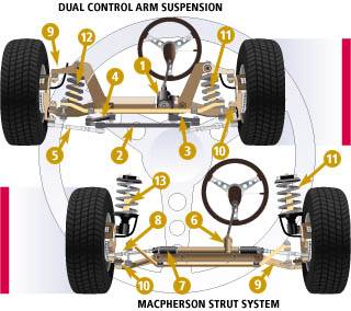

This picture clearly and obviously shows the distinct differences between a strut suspension and an upper and lower control arm suspension like the Mark VIII.
Steering Systems
1. Steering Gear Box
2. Center Link
3. Pitman Arm
4. Idler Arm
5. Tie Rods
6 Rack and Pinion Assembly
7. Bellows Boots
8. Tie Rods
Suspension Systems
9. Control Arms
10. Ball Joints
11. Springs
12. Shock Absorbers
13. Struts
Notice the difference between the Strut system and the Dual Control arm system. It is obvious from this illustration that the Lincoln Mark VIII system is definitely not a strut system. Why is this so hard to accept? It is obvious. There is a big difference between struts and standard coil-over or air spring shocks. This picture is the best I have seen so far to demonstrate the obvious differences between the two.
