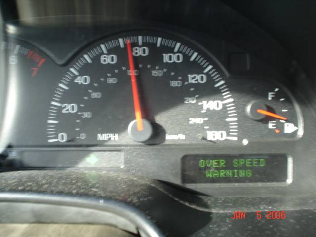

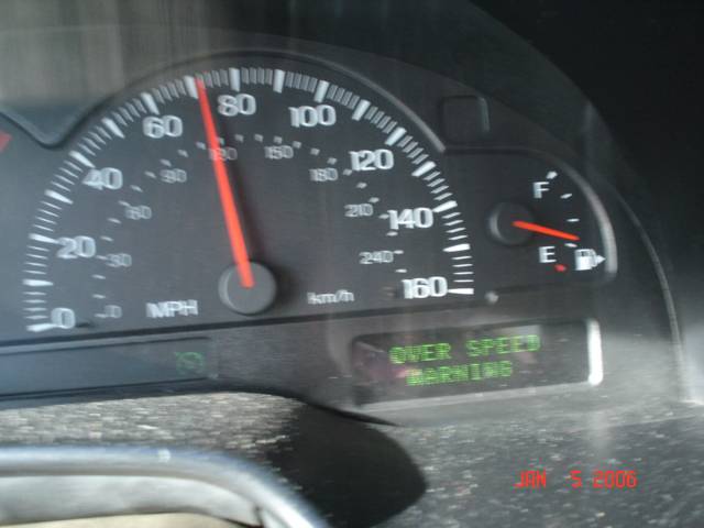

here are the pics of my unique LS showing an overspeed warning.... crazy huh
So what happens when you go any faster? The fastest I've gone in my LS was 100MPH and nothing came up.
I don't remember if you said you bought it new, but I would think it might have possibly been a rental car... I would ask the dealer about it.
i did a carfax report about 3 months ago and it had only one owner here in california....ive take the car over 135 with no problem but the cruise control light will flash
This is interesting. Someone must have the info on this setup. Glad it is not on mine as it would drive me crazy trying to figure out exactly what it was and how to set it at different speeds. Might be nice if you had a teenager who thought that it was making a record of their driving.:)
DING, DING, DING......
I sit corrected. This appears to be a dealer activated option. Your dealer should be able to remove this with their WADS. Why it was activated in the first place is another mystery.
I noticed in one pic the cruise light was on. Could it be that the warning is a reaction to you maybe going down hill and going over the cruise limit that the cruise is set at?

no the cruise is not set on.... it flashes on and off does not stay solid as when set to cruise...

That's crazy, why the hell that warning would come up at 70mph? I am glad that I don't have that message center. I have gone 135mph and nothing.
Yea Josh wash your car for the meeting or the dirty LS drivers are gonna pay for the dinner..
Does the car also ("ding") alert you when this happens as well? I'd talk to the dealership on this one. I drive at least 70 to work everyday. That would drive me nuts...

looks like your blinker was on too... maybe it's telling you to think again about turning at that speed...:eek: :D
