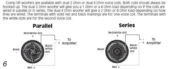

It's not real clear how you hooked up the subs. Are they Dual Voice Coil Subs? They perform ALOT differently based on wiring methods. You probably need to look into Ohm loads for your AMP and what type of Ohm load your subs will present depending on how they're wired. For the basic wiring, this might help:
DVC subs are sometimes a pain to wire, and can be easily screwed up. Get the wiring right, and they will hit pretty hard.
