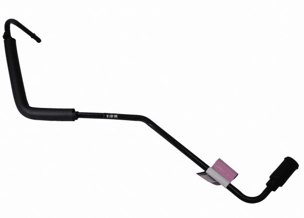

I am trying to acquire a new hose but neither AutoZone nor O'Reilly list the part on line, which is going to require a personal visit. Rock Auto has it, but unless I want to double its price with shipping charges, I won't get it until Thursday. I will try the only Lincoln dealer in San Diego on Monday to ascertain it's availability, but like the flywheel (my LS has a standard transmission) I may have to try the Jaguar dealer.

It's been several years since I replaced the PCV elbow on my now ex-wife's Lincoln LS, but back then (probably 2010 or so) I too was struggling to find the elbow. My dealer pulled a few items that he thought might work and the closest we found was a part for a V8 Ford truck. The part number of the stand-alone elbow that the dealer sold me was labeled as a "Connector" and Ford part number YL8Z-6A614-AA. The dealer had it in stock and it saves a few bucks over the entire PCV hose kit by application for the LS.
-Rod
I believe its the same part for the Escape... but the hose might be different.
IIRC... there's an o-ring on it that goes bad.

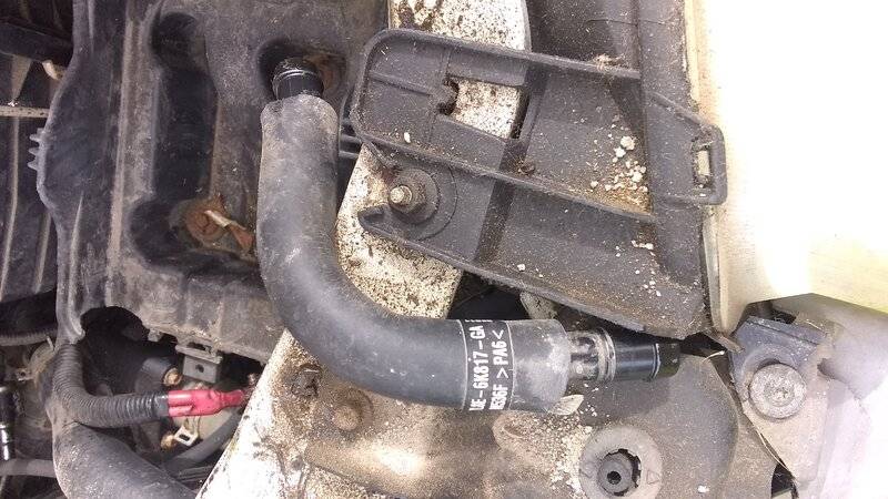

Hi 04_Sport_LS, that's not true, it is just a rubber elbow of around 5/8" ID, one end slips over the PCV and the other slips over a hard plastic line that leads to the air intake on the clean side of the filter. The PCV has an O-ring, but that gets changed with the valve itself.
And both halves of the intake need to be removed to access the PCV. It's not a terrible job, but it does open up another pair of gaskets that will either need to be cleaned and reconditioned, or replaced. Decent carburetor cleaner does the trick with some good rags, since the gasket is plastic framed with the ports having individual silicone raised seals on both sides of the plastic frame. You'd be cleaning 24 individual port seals up if you wanted to re-use the gaskets.

The PVC system is not a hard line on the Escape V6... but a few rubber hoses connected with nipples... and a rubber coated plastic elbow.
PVC valve is still a pain to get to on the Escape... even though the engine is transverse mounted.

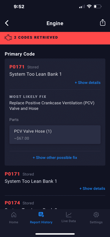

P0171 is fuel system trim too lean on bank one.
Many things can cause that code, and a bad PCV valve might on cars that have a PCV valve. (Note that the V8 LS does not have an PCV valve but can produce code P0171.)
I am amazed that so many miss the fact that the OBD codes almost never identify a faulty component. Instead they indicate what parameter(s) are out of range and give a good clue at what parts to look at. Still, there is always a troubleshooting flowchart to follow for each code. If people would follow that diagnostic step, they wouldn't have to throw multiple parts at a car until they stumble on the right one.

Ok thanks for the advice. But when I pulled the code P0171 is stated most common fix would be the pcv valve and hose…
you need to see what happens to long term trims at cruise. if they come down it’s a small vac leak
