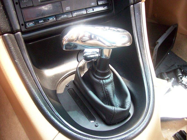

B&M (ratchet?) shifter?
It should fit (81001), you'll most likely have to mod the console for it to fit though and figure out if/how to bolt it down. The OD button is on the base of it. It doesn't come with a cable so you'll need to make yours work (I don't know how different it is from the AODE cable, but I know others have this working on a 4R70W.)
Find a translator on look at this page:
http://www.mundomustang.com/foro/index.php?topic=4755.0
http://s91.photobucket.com/albums/k307/skyline746/?action=view&current=MVI_0523.flv
I dunno, try it out and let us know :cool:
I looked up the part on summit (81001) and it lists for both the AODE and 4R70W.
I wonder if this would work better in a 2nd Gen console vs a 1st gen.
it wont matter what console you use, the area around the shifter in a 1st and 2nd gen console is pretty much the same, but a 2nd gen console will not mate up to the dash in a 1st gen if you try it, where the console meets the dash, a 2nd gen cosole is about an inch shorter then a 1st gen. either way you are gonna have to butcher the console to fit a ratchet shifter in there.
I was hoping you would respond. I was acually lookin at this shifter, and I think I might be able to make it fit in the console (gen 1). I might have to trim the non-wood portion of the piece around the shifter. What do you think?
hey... that might not be such a bad idea.. if you can figure out how to do such a mod... make a post on how to do it..
