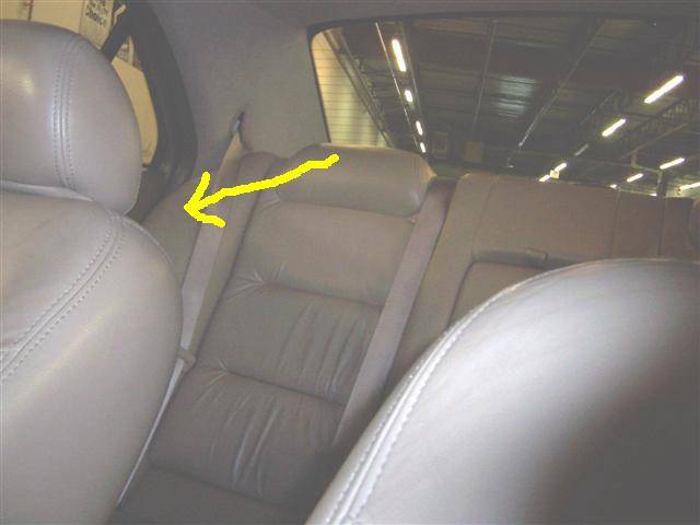

does anybody know how to get the backseat off? im not trying to take the whole thing out, just the little vertical piece next to the door... when i got in my accident it popped out and im trying to take it off so i can put it back on properly... i posted a picture jus incase you dont know what im talkin about
hopefully that whole seat isnt one whole piece... im pretty sure its not tho... somebody help me out

Removal and Installation
1. Using a suitable tool, release the mini-buckle.
2. Release the two latches and remove the rear seat cushion.
3. To install, reverse the removal procedure.
-Check the restraint system for correct operation.
Seat — Rear Seatback
1. From the luggage compartment, release and fold down the seat backrest.
2. Remove the rear seat backrest nuts and remove the seat backrest.
