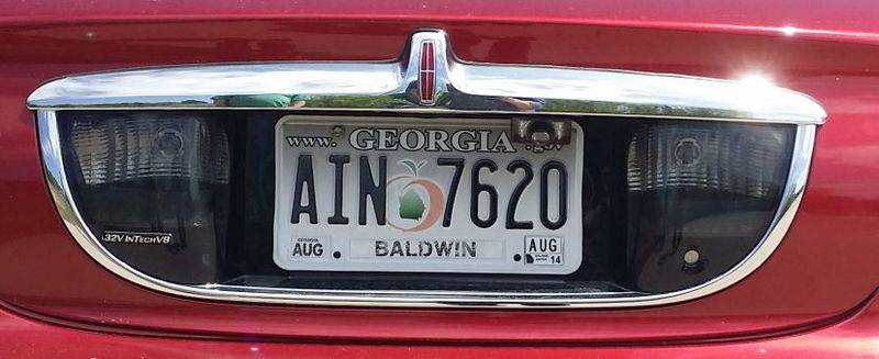

Here we go --
Backup camera:
and the resulting picture:
The camera adds the distance marker lines, not the unit. Through testing I found that for my install, the last line = 2 feet from the obstacle, meaning that if an object reaches the bottom of the picture, it'll be touching my bumper.
The camera's night vision works great. Combined with the reverse lights there is illumination as far as I wish to see. The camera has a flat mounting base that provides the 45 degree downward view, and I used 3M trim adhesive tape to hold it in place rather than trust fasteners that can rust later on.
