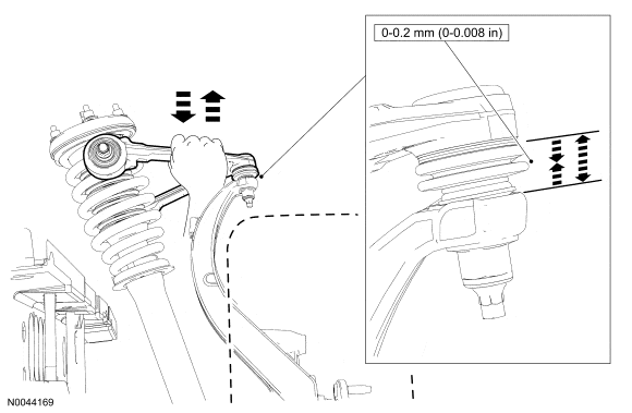

Ball Joint Inspection
  1. Prior to inspecting the ball joints for wear, inspect the wheel bearings. For additional information, refer to Section 100-04 .
  1. NOTE: In order to get accurate measurements, the suspension must be in full rebound with the weight of the vehicle supported by the frame.
    Raise and support the vehicle by the frame to allow the wheels to hang in the rebound position.
  1. Inspect the ball joint and ball joint boot for damage.
    • If the ball joint or ball joint boot is damaged, install a new ball joint. For additional information, refer to Section 204-01 .

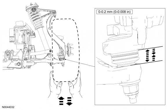

NOTE: Carry out Steps 4-6 to inspect the lower ball joint. Carry out Steps 7-9 to inspect the upper ball joint.
    CAUTION: Do not use any tools or equipment to move the wheel and tire assembly or suspension components while checking for relative movement. Suspension damage can occur. The use of tools or equipment will also create relative movement that may not exists when using hand force. Relative movement must be measured using hand force only.
    NOTE: The weight of the wheel and tire assembly must be overcome to get an accurate measurement on the dial indicator.
    Inspect the ball joint for relative movement by alternately pulling downward and pushing upward on the wheel and tire assembly by hand. Note any relative vertical movement between the wheel knuckle and lower arm at the lower ball joint
    • If relative movement is not felt or seen, the ball joint is OK. Do not install a new ball joint.
    • If relative movement is found, continue with Step 5.
  1. NOTE: In order to obtain an accurate measurement, the dial indicator should be aligned as close as possible with the vertical axis (center line) of the ball joint.
    To measure ball joint deflection, attach a suitable dial indicator with a flexible arm between the lower control arm and the wheel knuckle or ball joint stud.
  1. Measure the ball joint deflection, while an assistant pushes up and pulls down on the wheel and tire assembly, by hand.
    • If the deflection exceeds the specification, a new ball joint must be installed. For additional information, refer to Section 204-01 .
    • If the deflection meets the specification, continue with the procedure.
    CAUTION: Do not use any tools or equipment to move the wheel and tire assembly or suspension components while checking for relative movement or suspension damage can occur. The use of tools or equipment will also create relative movement that may not exist when using hand force. Relative movement must be measured using hand force only.
    Inspect the ball joint for relative movement by alternately pulling downward and pushing upward on the upper control arm by hand. Note any relative vertical movement between the wheel knuckle and upper arm at the upper ball joint.
    • If relative movement is found, continue with Step 8.
  1. NOTE: In order to obtain an accurate measurement, the dial indicator should be aligned as close as possible with the vertical axis of the ball joint.
    To measure ball joint deflection, attach a suitable dial indicator with a flexible arm between the upper control arm and the wheel knuckle or ball joint stud.
  1. Measure the ball joint deflection, while an assistant pushes up and then pulls down on the upper control arm, by hand.
    • If the deflection meets the specification, no further action is required.
Sometimes wheel bearings can be bad/sloppy/loose... and still run silent down the road.
As far as this:
... that basically means no pry bars. I've witnessed "wanna be" mechanics take 5 foot pry bars, and hang on them to check a ball joint. Not good.
The 12/6 method checks for lateral play... but not vertical... so the manual has it correct for vertical movement... but the joint can have lateral movement too.
With the lower knuckle ball joint... you'll want to pull the tire off and use the same method as the upper arm.
The reason for jacking the lower control arm up... is so that the suspension/ball joint isn't in a bind at full extension due to the spring pressure.
I know some people disagree with my suggested method... but it prevents a false negative... similar to my reasoning on the sway bar links, which could be checked with the car on the ground also.
