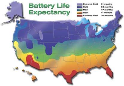

batteries do not last as long as you think....
I believe this chart. I lived in NJ for 36 LONG years. 4-5 years on a battery was about right. Now in Florida 3 years, and there dead.

Well one thing is for sure... they sure don't make batteries like they used to... Seems now if you kill a battery more than twice, it's toast. We got 6 years out of the batteries in our 86 F250 with the diesel. In the really cold weather, we killed it fairly often until we fixed the glow plugs. Now? Sheesh... About the most reliable one I've seen recently is an Interstate. They seem to be fairly hardy...
