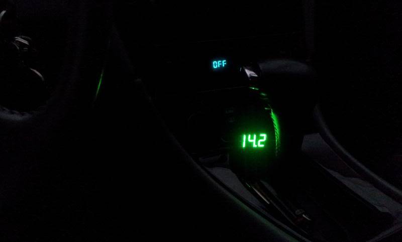

Upon startup I'll see 14.6.14.8v, after a little driving it'll go down to 14.2 and will finally rest @ 13.8-14v all nice n' hot.
Mine starts in the morning at 14.2-14.4 and after running around a little, it usually rests at 13.8-13.9 and when shut off, it shows 12.6-12.8 and I have been watching it since I put the alternator and new battery in. Installed a temporary digital meter next to the cig lighter.
