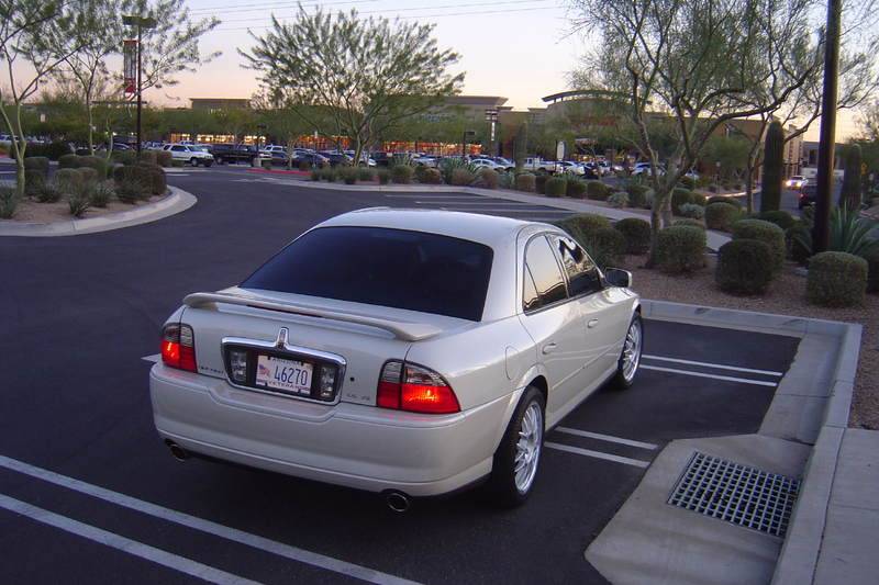

Eibachs. I've had them for 3 years now, and love them. Not too low, but with a set of 18's the stance and appearance effect is lower and slightly longer.

I have Eibach pro-kit with the camber kit. I have had the LS lowered for over 4 years now. The Eibachs gave me a 1.75" drop once they settled. Sitting on 19's. No rubbing or alignment issues of any kind.

Eibachs are a great spring, but be advised that the 1" drop ended up being just over 1.25" on my car. .25" may not sound like much, but trust me it can make a world of difference. I hit the frame just behind the wheels if I am not careful exiting driveways with lips and when negotiating parking lot speed bumps. Also I have to watch closely if I am at a strange car wash (while traveling) as the little bumpers some use to stop the car from rolling as it comes off the line will also drag on the frame as the car compresses the spring after going over the bump.
I can only speak on what I’ve used and what I’ve used is the Eibachs. I have 18’s and they give me the stance I wanted! I wanted to go lower to start off with but around here Austin, Round Rock, Tx area it’s pretty bad on the roads as far as nice flat roads go. With the 1” ~ 1.25” drop it’s enough for what I’m looking for. If I do this again (get another LS) I’m going to put on the Eibach camber/alignment kit with the lowering springs.
