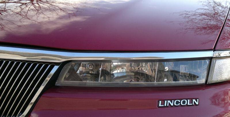

I have a 96 with non-HID lamps. The insides are nice and the outsides are not fogged and the lights are decent enough compared to most i hear from out there with bed reflective material or fogged glass/plastic. I have Sylvania Silverstars so far. I would like to know what people have had success with like the new Sylvania zXe's or PIAA's or Nighthawks or whatever. What are you runnin? and no , I'm not converting to HID's. I would like a whiter/ bluer look but not at the expense of worse visibility. and I want the similar 65 wattage as i dont want a harness upgrade , just a better replacement. low or high beam , what do ya got?
