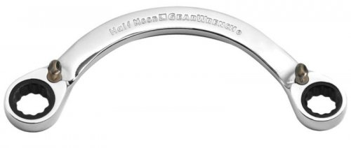

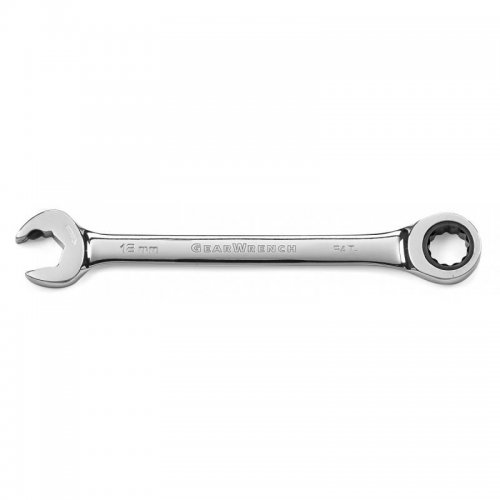

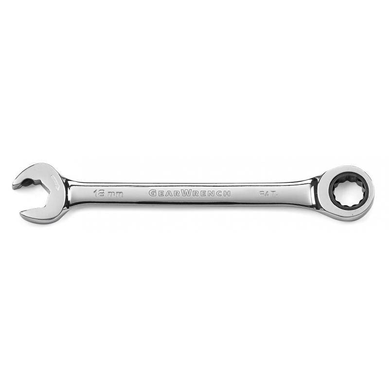

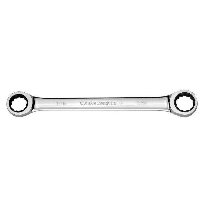

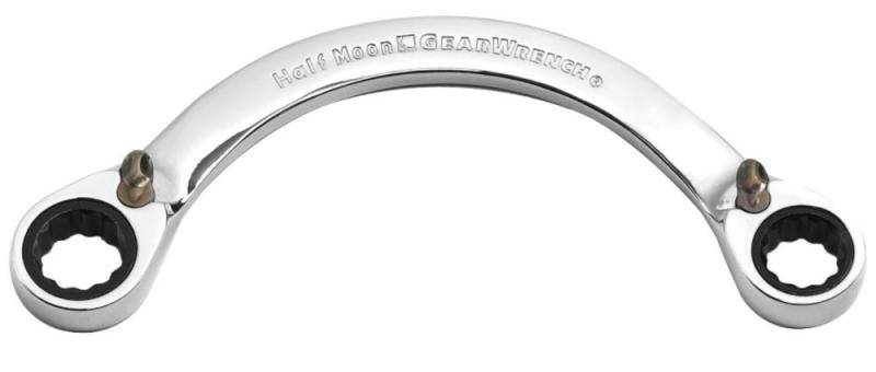

So I looked into the gear wrench that I found many on here talk about. They even listed links, but with the thread from 2011, they no longer worked. I found many different "gear" types and hope that those that have done this previously will provide their thoughts on which would work best. long, stubby, S or C shaped etc. See below.
C-shapped -gw.jpgFgw.jpgGW to ratchet.jpgGW to ratchet1.jpgGW.jpgGW1.jpgs-shaped=gw.jpg

No opinions?
I would think the first is the best (C shape), I would think this would fit around the master cylinder and give the most back and forth movement when ratcheting
well, i have only ever used the straight style.
and it worked well enough.
not sure if another style would better or not honestly.

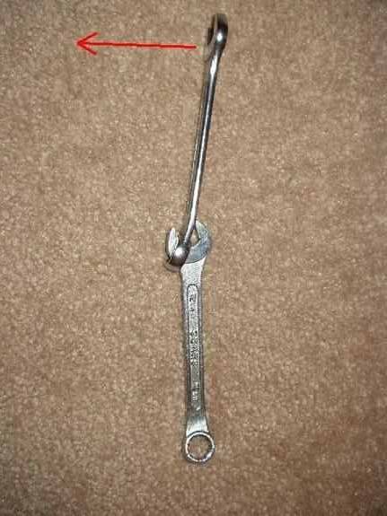

1 straight 18mm ratchet wrench & another wrench close to the same size.
Put the ratchet wrench on the rear drivers side bolt & hook up the closed end of another wrench to the open end sticking out. The wrench you hooked up to the ratchet wrench gives leverage and acts as kind of breaker bar
As for the air bag & 15mm bolt, you don't really need to remove the strut entirely as much as you just need to move it out of the way to slide the bolt out. Of course this will consist of you bleeding the air bag by removing a clip on the solenoid valve and giving it a twist to release the air. Once the air is released you can press down on the bag to swing it out of the way and continue on your work.
Thanks Scallywag. Are you saying the bolts won't come out unless I remove the shock bolts to move the shock/airbag out of the way?
I had to remove the 3 bolts at the top of the shock and push the shock down far enough so the bolt closest to the front could get past the air bag solenoid.
I used a straight 18mm ratchet and think the second one pictured above would work a bit better. I also used access hole to remove, once loose this was pretty easy and only took a minute or so to get the nut off.

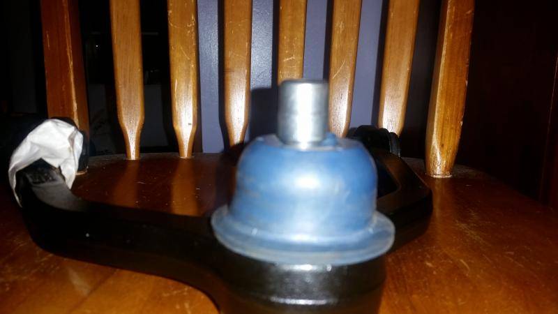

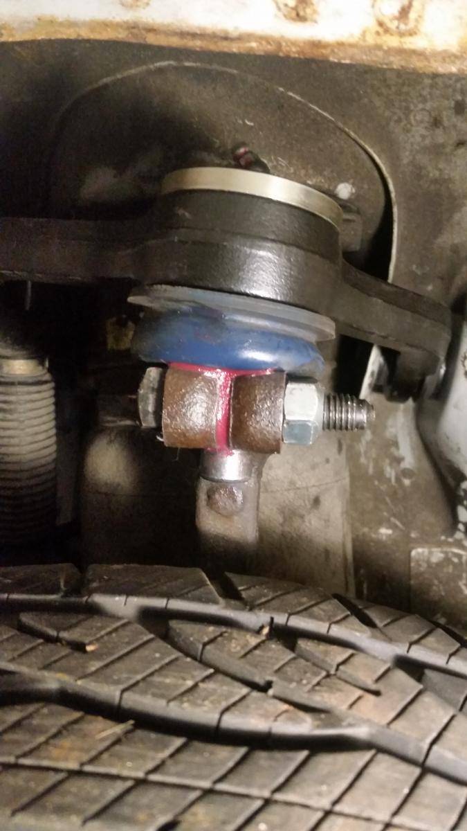

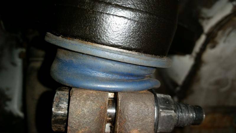

The ball joint rubber grease cover comes down much further than that of the original. and sits on the spindle/knuckle where the UCA bolts to the spindle. I'm a bit concerned that it will rub and eventually wear out. I also noticed what looks like some very tiny cracks and wanted your opinions. They are AC Delco Pro grade. Yes it is filled with grease.

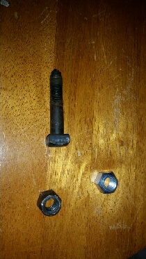

Also the new bolt is hexagon vs. the square original and doesn't lock into the spindle. I would have liked to use the old bolt with the new nut supplied. Would there be any issue with that?
Please give me your opinions on the blue grease cover. is this how yours look? I tried to push it up but it wouldn't stay. I almost think it wasn't manufactured properly, but maybe it is made tougher?
I attached the pic of the other arm not installed - they both looked the same when I received them.

There is no problem using the OEM bolt with new nut. I've bought TRW, Moog, Dorman & Mevotech UCAs for my various Marks but continue to use the square bolt because the hexs (in my experience)come with a lip/flange that wont allow the bolt to sit flush with the knuckle. Of course, we want everything to be buttoned up nice & tight so the square bolt wins by default
In my experience, the UCA bushing always looks a little awkward in the end because it has to be forced up to expose the groove on the ball joint stem to allow the bolt to slide on home. After pumping the bushing with grease it would attempt to get form again but never have I had a UCA bushing go back to looking plump. One time I did manage to leave the bushings plump but ended up getting grease splattered to the upper wheel wells. This is most likely because I left the grease valves in place and everytime the UCA would do its job it'd squirt out grease from the valve.
So I just leave the bushings the best I can get them to look and haven't had issues just yet.

I went to Brafasco today to buy new locking nuts. I didn't like the way the new nut with washer built in was pushing up the ball joint grease seal. This bolt and washer came with the UCA. The blue cover/seal was sitting on the edge of the washer, built into the nut. Not what I call professional grade, even if the manufacturer does list the part as Pro grade.
I didn't like the way it looked so creased and didn't want it riding on edge of the washer nut, so I took it out of spindle filled it with grease and used the original bolt (square head) and the all steel locking nut I bought. I looked at the nut that came with the UCA and it too was all steel, no nylon lock at the end as the original.
So if you take your time and fill it with grease first, it will go in much better and look as it was meant to.
