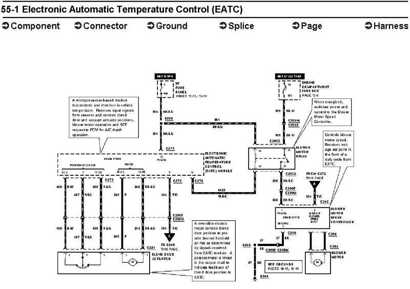

my blower motor just quit working out of the blue,
i tried messing with the cables on it as per the tech article, and nothing
is there a fuse anywhere that could of blown?
im not to car tech savvy
My guess is the blower motor connection behind the glove box, happens OFTEN.
+1
On my third harness, and second blower motor in the same car. Second motor because the male prong burned so bad it fell out of my last motor.
Running a/c for 14 hrs straight kills 'em.
