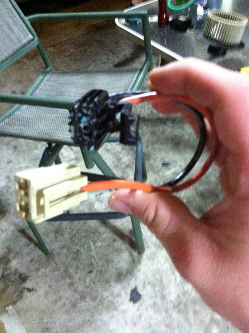

Ok, so Ive had numerous issues with my blower motor over the past year. It intermittently turns on and off, which has been driving me crazy. I decided that it was time to inspect and diagnose the issue... Once I pulled out the glove box and unhooked the harness's, I noticed a decent amount of condensation in and around the unit. I know from past experiences that this can be caused by a small leak in the passenger side wiper motor. I found and successfully sealed up this leak. But now I am left with a damaged Blower Motor, Relay Resistor, Relay & Harness. I was told that Ford doesn't make a factory replacement option for the Mark VIII. So I decided to go with aftermarket (( Replacement )). The problem I face now is finding a used harness. It connects Resistor to the Blower Motor.
It looks like this...
Is anyone willing to sell me an extra harness ? Or possibly have advice on a aftermarket option ?
