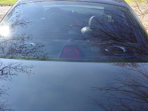

i did install 2 8" RF S1s in place of the 6x9s but it wasnt enough power and sounded like $hit. looked pretty cool. check the pics. (hope im not rambling im pretty drunk)
