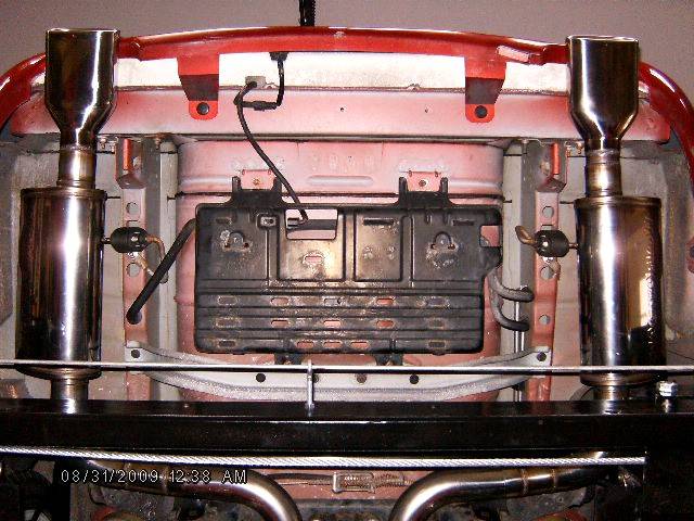

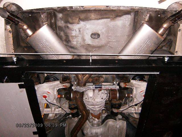

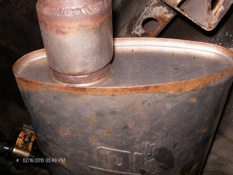

I'd recommend against the Borla's. I've had some Pro XS mufflers on my SC (first 2 pics) for a little over 4 years, and this is what they look like now. :(
The car doesn't get driven in bad conditions.

304 SS shouldn't look like that after 4 years, they used something in the welds other than a 309 filler. :mad:

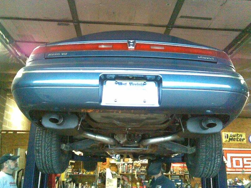

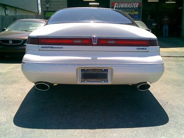

I've gotten a few compliments on the Magnaflows I have. I have stock exhaust with just the rear mufflers replaced with Magnaflow Race Series with tip (14851.) They can be used on 2 1/4" or 2 1/2" pipe as the pass through is the bigger size. They have a nice deep rumble at idle (a hair quieter than what I wanted, but nice.) When you open them up, especially when the irmcs open they sound great, though again a tiny bit quieter than I hoped. You can still hear me coming or going though, a good sound for a Lincoln imho ;)

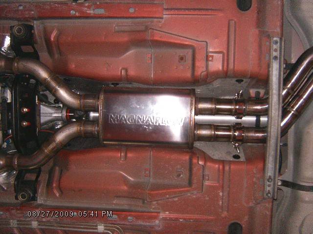

I put the Magnaflow x muffler in place of my h-pipe Friday. It was straight -piped from the cats back. It's about 3X quieter than I thought it would be. It sounded RAWR wide open but now it sounds about 2 notches up from stock. For what it is, it muffles well. I'm considering burning the insides out to get some of my balls back!

You lost me, I just have the one magnaflow, it was wide open with an H. The H sounded like ass compared to an X. I fixed that. I don't see how putting more mufflers on it would make it louder? I may have misunderstood.
I got the short one, i'm so used to driving with nothing but pipes & an X or H, that the muffler sounds too quiet in the car. I just took a vid & now see that it's actually pretty loud out back. Maybe my neighbors won't hate me so much now.:)

The Magnaflow 14386 I used is a 14" body (they do make an 11" body though, 14379). I don't see the need for another x-pipe though, the 14386 has a built in x-pipe.
Then it is the 11", was not sure on the size without going to magnaflows web site, the 11" I believe does not have the built in x, that is why I mentioned that type of install.

It would appear that you are correct about the Magnaflow 14379 not having the Tru-X core.
