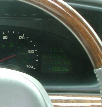

Thanks but ... it's part of the digital read-out display as per the image attached. It's not a bulb and, no - no weather issues that I can notice other than, perhaps, bright and beautiful.

Sorry, misunderstood, thought you meant the brake light, not the LCD display. It's probably a short/corrosion somewhere.
gotcha! I'll clean it and repost (or bump it up) if it reoccurs.
Thanks very much - appreciate the help!
